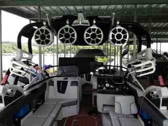

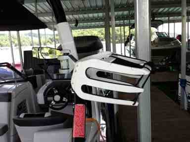

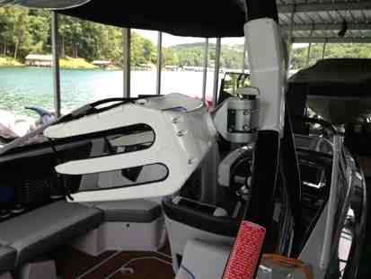

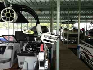

                        As promised...Click image for larger version
ID:	366646Click image for larger version
ID:	366647Click image for larger version
ID:	366648Click image for larger version
                        • lion90
                          • Apr 2009
                          • 182
                          Thanks. So you actually mounted them such that they point downward. In that case, make sure the strap doesn't break since it seems the boards would slide right out.
                          There wasn't enough room when mounted like the silver and red boat to swing the racks in with a board on top? It seems like there should have been.
                          Sent from my SCH-I545 using Tapatalk 4 Beta
                          • imoveteeth
                            • Jan 2013
                            • 16
                            • Mason, OH
                            No. I tried a few different ways. You might get a small surfboard in the way the red and black boat did it. It angles down but with the rubber in there they don't really slide even without the bunny. I wouldn't drive the boat without it the bunny strapped. I've had it this way for two weeks so far with no issues. Until there's a commercial solution, this seems to work fine. Also seems easier to engage the locking pin from the top since I can just pound my fist on it...
