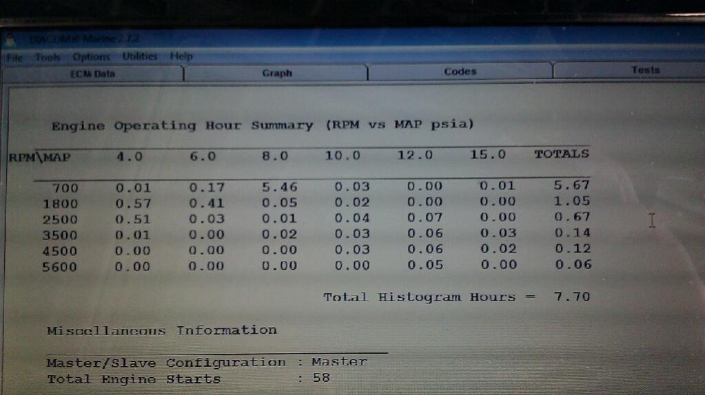

    It looks like everything is getting worked out for the most part. 5.67 hours were at 700 rpms and 1.05 were at 1800. then very few above that. I believe it was a problem either at nautique or pcm. I still haven't heard what. All in all I just want my g23!
    My opinion is that is to much idle time for an engine being broken in.

        Here is the report.

          Originally posted by fatchance720 View Post
          Here is the report.
          Spent 3 minutes near WOT - that was probably the break in runs.
          Otherwise very strange they would let it idle so long. Like they started it and got distracted with something else. I hope it was in the water and not on the garden hose.

            I am sure it was idling while the dealer showed other people around the boat. but 58 starts? That seems to me like a lot for 7 hours.

              Absolutely. That washes the rings right out. Idle is just as bad, and in some ways worse, than WOT on a new engine. If this were a motor we were building and it had an hour of idle I'm at least doing a leakdown and possibly a compression test. If time is no factor I'm taking the head off and putting in new rings just to feel better about it before handing it to a customer.
              If its me, that's no dice. Sorry to say...

                      I appreciate everyone's responses. The engine had 5.46 hours of idle time pretty early on that no one can explain. The dealer says Nautique has not given any explanation so far. I can see how this may look silly for someone who isn't shelling out a $30 a day payment for the next 15 years of their life ( not including gas or insurance ) and for someone who will still owe almost $70,000 on a boat after 8 years of payments. (3.9% interest) Nautique is supposed to be the best out there that's why this is so concerning to me. I honestly am not a engine expert and have no idea what to do.

                        Trust me, I wish Nautique had put that many hours on mine and figured out the issues. Mine came and the dealer found that a cylinder was misfiring and not working correctly, PCM shipped out a new engine and had it installed. I have had repeated issues of the engine not starting since that they haven't figured out yet. I would take my engine coming with whatever hours if they were able to get things sorted out and it ran correctly. You are worrying about hours when they haven't equated to a problem and more likely equates to issues being ironed out.

                              As everyone has said 7 hours on the boat to troubleshoot it is one thing but 7 hours of dealer playtime is another. Being over 58 starts in those 7 hrs sure is strange to me also. That's 1 start every 7 mins! Call the factory and ask them.
