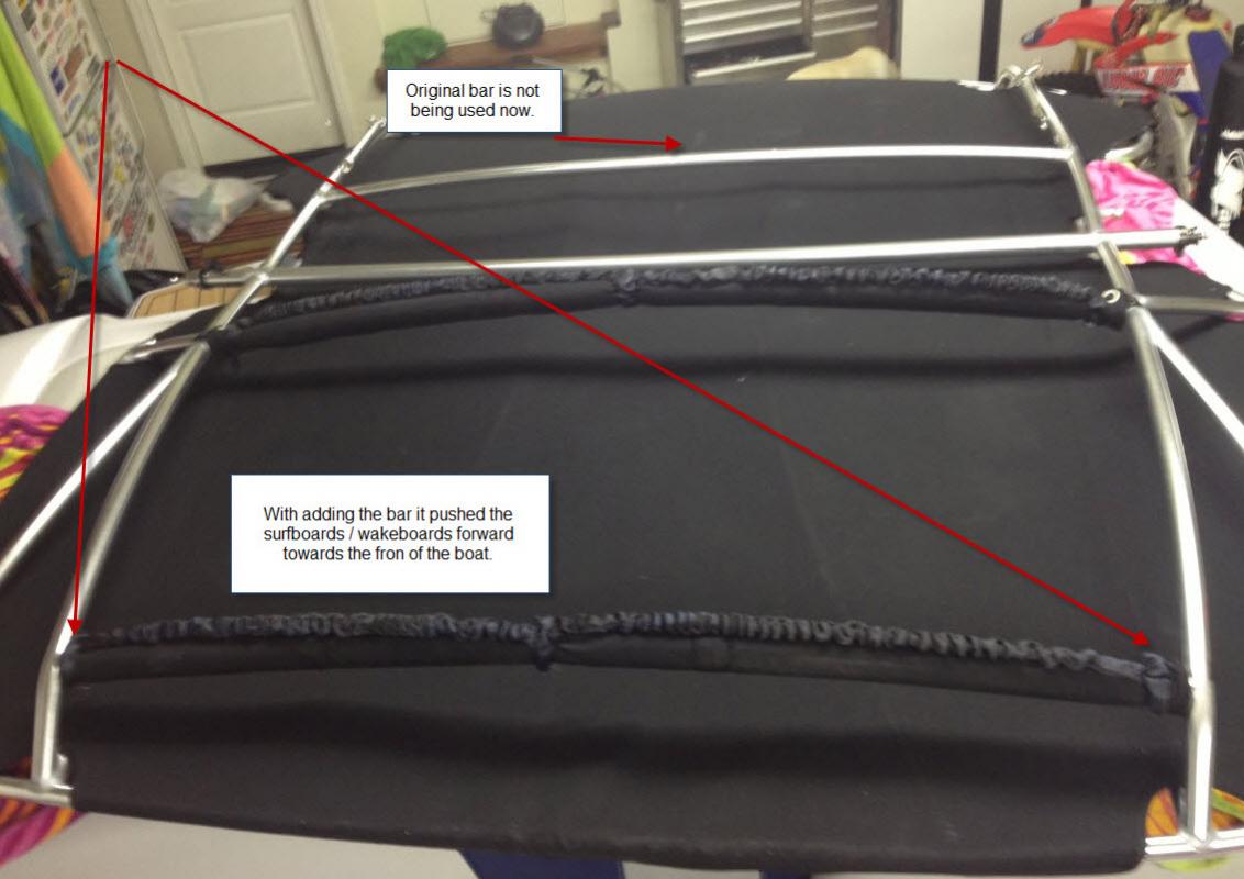

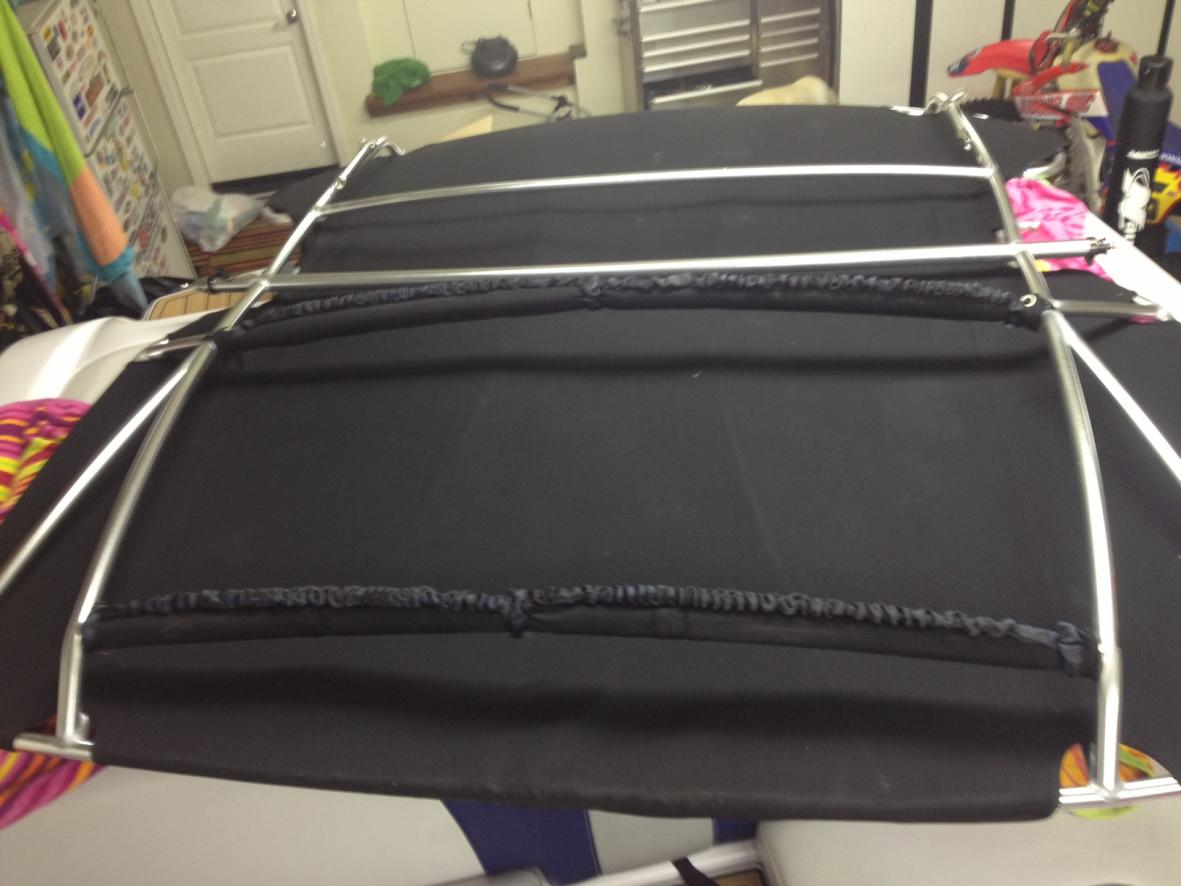

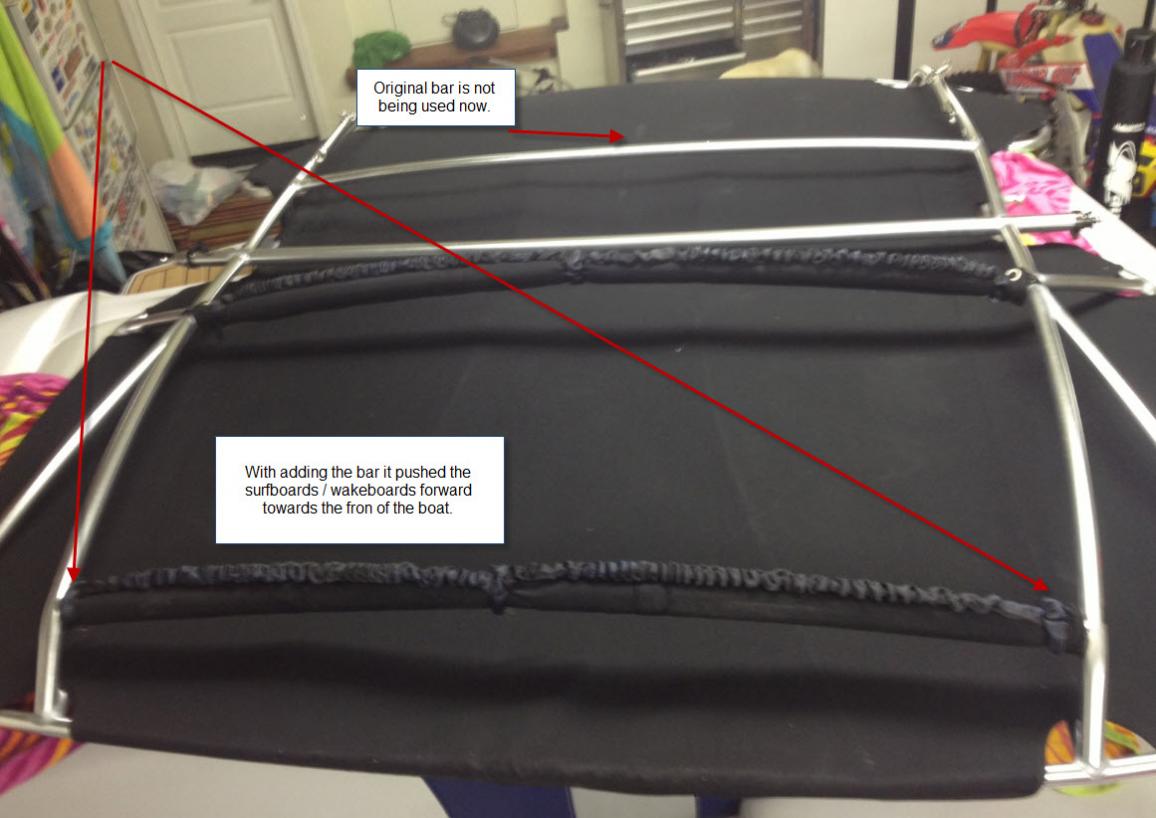

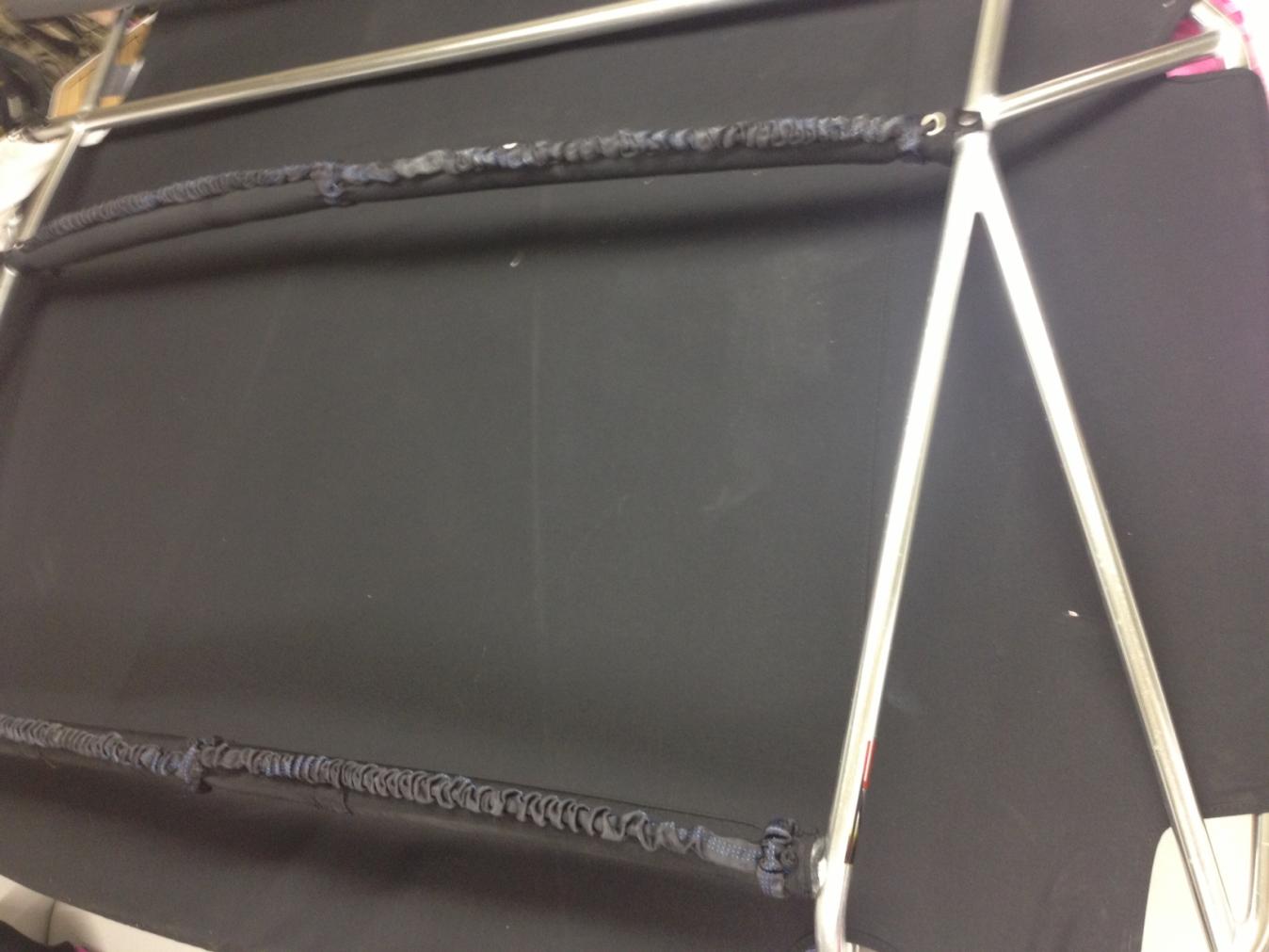

    Came up with a pretty good idea. I have a 2009 SANTE with the FCT3 tower with a Z5 rack along with 4 Wetsounds Rev 10's on the tower. Typically we do alot of surfing and when storing boards on the Z5 rack the board always hit and scratched the speakers since the standard bows and pretty far back. I went to the medal supply and picked up 6 feet of 1 inch 6061 Aluminum Round X 1/8 and had it formed it similar to forward bow and welded it ( looks factory ).

    Nice idea. When you get a chance can you post pics with it loaded?

      Nice job, had a friend do that with a black rope and his works great.
