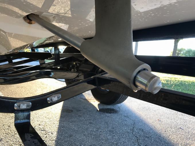

    So, the boat is a 2017 G23. 30 hours on it. We have never hit anything and had no issues with prop or shaft. I check it as part of my "pre flight" before we go. Today, after hitting a few waves off another G23 I heard the engine rev as we hit the crest of the wave and as we came down on the back side of the wave the boat stopped producing thrust. We came to a stop with the power in neutral and let the boat settle a bit. Tried giving it thrust again again forward and back and nothing. At first I thought I maybe broke the sheer pin off. I shut off the boat and jumped in to find no prop on the boat. After getting a tow back to the trailer and getting it out of water I found the entire shaft have broke but in a clean break. No scratches or damage to anything else including rudder. The shaft just flat out broke off. The dealer rep met me at the ramp and looked it and thinks it looks like a bad shaft. 30 hours on boat and we have only taken it to Lake Austin and Travis. Today we were in Cypress Cove and were at a depth of around 80 feet. They think it will be covered by Nautique (hopefully so). Has anyone else ever seen something like this? Could it have broken from hitting some waves from another boat hard? I cannot imagine in all the year I have been on a boat that hitting a wave hard would break off a shaft and if we hit something in the water I should leave damage on the rudder or somewhere else...Nope, nothing.
    Thanks ahead of time. Click image for larger version
ID:	515561Click image for larger version

              Yep, that's exactly where the shafts were breaking on the early G-series boats with the bad shafts. You're certainly not the first, but that problem was supposed to have been solved.

                    I have the H6DI 450hp on it. Brought the boat in today and had a call with the head of warranty at Correct Craft. He called me after talking with the store. He sincerely apologized for the issue and they are overnighting new parts to the shop on Monday to get it fixed asap. They are also asking for the old parts back (minus prop since its 80 feet down). Store had said they have seen one other 2017 with the same issue. Its happening where the keying is on the shaft where the prop connects. Just a defective shaft. I will say I am amazed at the customer service with the dealer as well as Correct Craft. They want this fixed asap and want to get to the bottom of it asap. Yes, its an inconvenience but they are doing everything and more to make it right. Other than the actual break, no complaints and I would hope all customer service issues with anything I own go this smooth.
