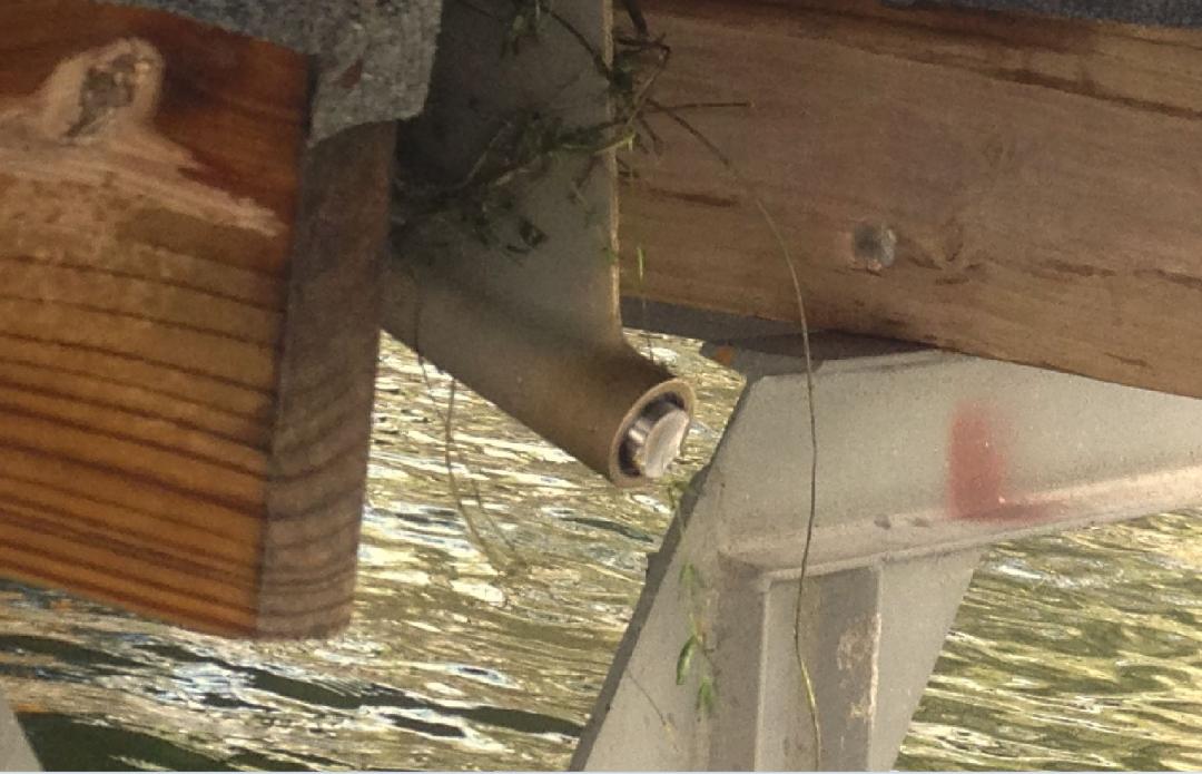

          Zoom picture of shaft failure areaClick image for larger version

            The duck weed or seaweed is from when the towing company towed me for 10 miles, and got wrapped around the shaft area when they were towing the boat in shallow water
