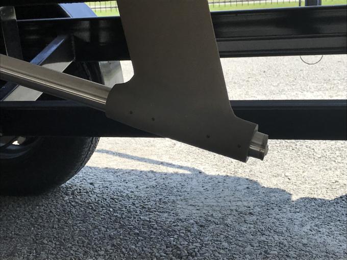

        For those still counting...yesterday had the same issue on our 2014 G21, driving about 22 mph across the lake, didn’t hit anything, no ballast at the time only 2 people in the boat. Have 90 hours on the boat, 409 engine. Other than that great boat..

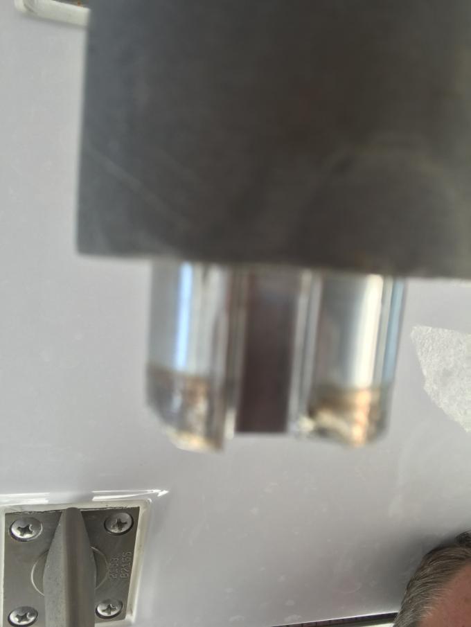

          It would be great if you could rotate the prop shaft to get a picture of the key way. Every shaft failure I have seen has the key way cut extended nearly to the strut. The "new" shafts have a shorter key way that is completely covered by the prop hub and well short of the strut reducing the weakness caused by the key way cut.

                Here’s a picture of other side of shaft. Everything was replaced by Nautique under warranty.

                  My G23 2017 with 378 hours just scrummed to shaft break while surfing today. Another one bites the dust.

                    If I remember you posted a pic of your shaft months ago and it was one with the longer keyway. That still is the common denominator.
