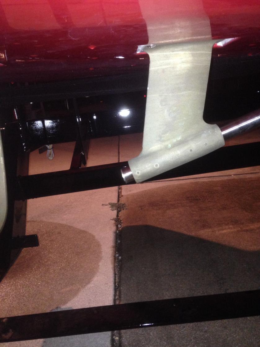

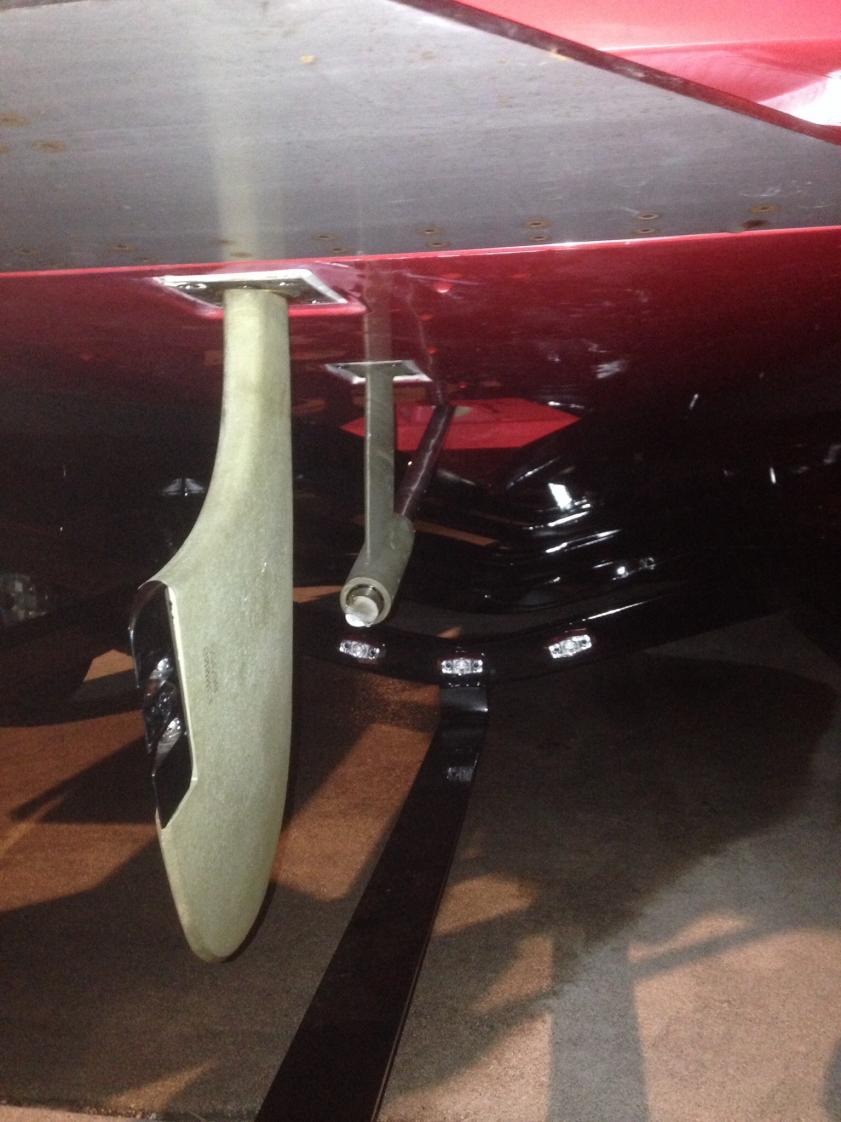

              #96
ID:	368465Click image for larger version
ID:	368466Ok I wasn't going to bring it up but safety for my family and yours is weighing on me. I just bought a 2014 g23 2weeks ago and had it out for the second time ,with about 12 hrs on it. My wife was slaloming and we were running 30 mph ,smooth as glass water ,had pulled everyone all day. The boat had been flawless all day. The boat started to shake and I pulled up immediately and we got in water to check prop .... It was gone and shaft was gone to. Hmmm we got towed in and put it on trailer and here are the pics ...
              btw my dealer never blinked and eye about meeting me to exchange me out with another boat ... He did a great job .

                          Originally posted by B-rad View Post
                          [ATTACH=CONFIG]28813[/ATTACH][ATTACH=CONFIG]28814[/ATTACH]Ok I wasn't going to bring it up but safety for my family and yours is weighing on me. I just bought a 2014 g23 2weeks ago and had it out for the second time ,with about 12 hrs on it. My wife was slaloming and we were running 30 mph ,smooth as glass water ,had pulled everyone all day. The boat had been flawless all day. The boat started to shake and I pulled up immediately and we got in water to check prop .... It was gone and shaft was gone to. Hmmm we got towed in and put it on trailer and here are the pics ...
                          B-rad, can you post a pic of the back of your boat?? Where is your surf pipe??
