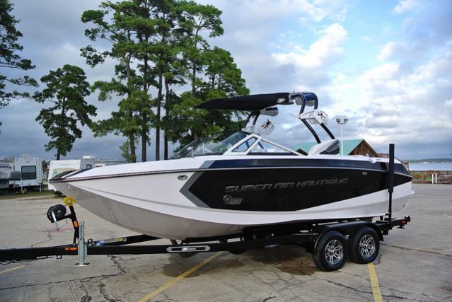

                          OK so I finally got my 2014 G23 550. The graphics werent tone on tone as much as id hoped for in pictures but overall im very pleased with it.
