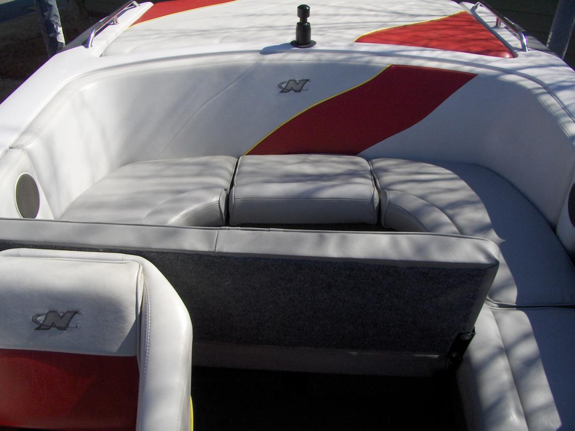

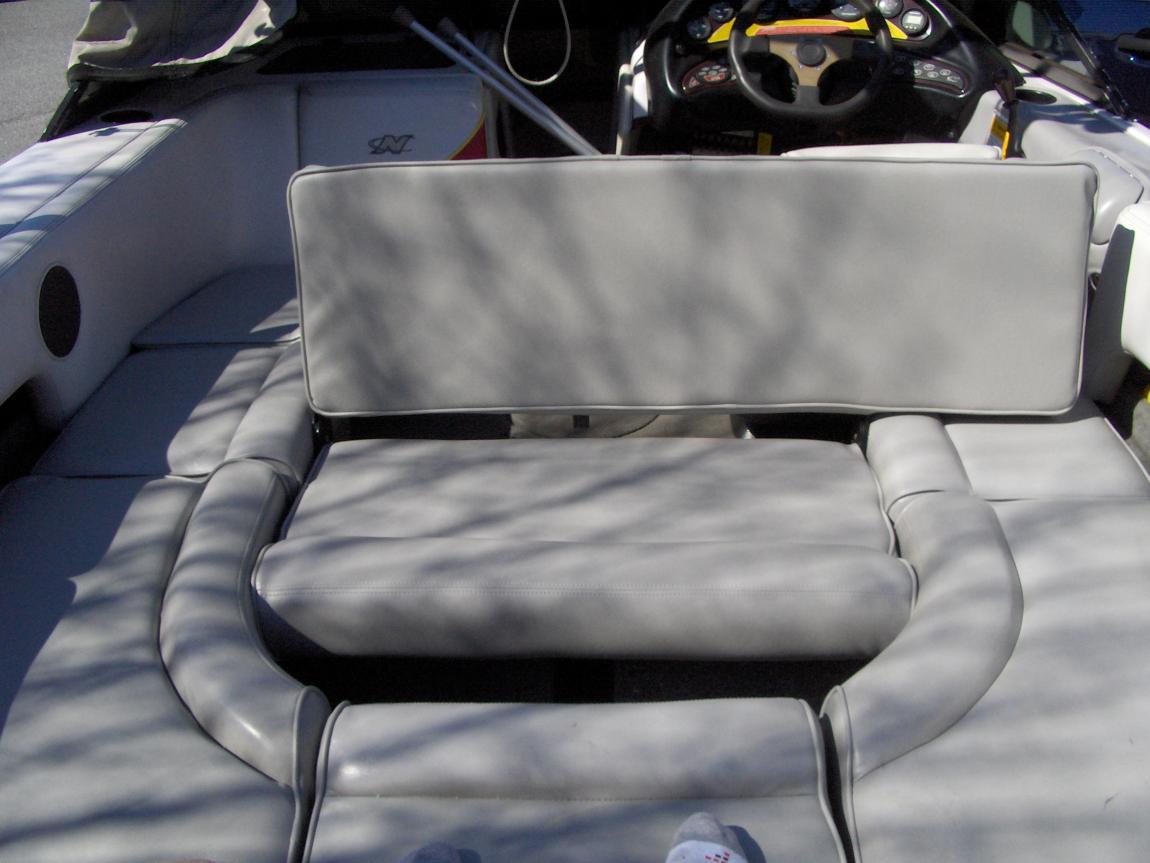

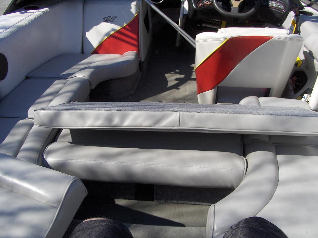

      The seat is finally completed. I am pleased with it. It was my first major project and I made a few mistakes, but overall I am happy with the results. The seat is a really tight fit. I measured about 10 times, but with the foam being a little bigger than the wood base and the vinyl, it makes for a tight fit. Also, the hinges I used are on the outside of the seat so that makes for a squeeze.

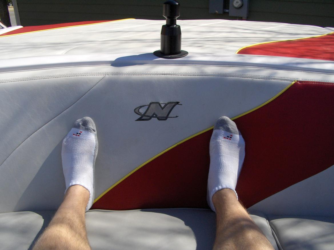

      I was able to place the seat in the boat today an take a few pictures. The SAN/Super Sport is a tight area to begin with and this seat takes up most of the main lounge. For reference I am 5'8 and I can stretch my legs straight out when sitting on the seat. I figure we can probably use the seat if our crew is 6 or less. One driving, 1 riding, 1-2 on the rear facing seat, 1 behind the driver, and one next to the driver. There is still seating in the bow so we could sit someone up there or maybe go up to seven for our crew. If we aren't going to be riding a ton or we need a little more room it takes less than a minute for one person to remove it.

            Sorry for the delay, I was having trouble uploading so I had to dig for my old camera.

              That looks awesome. Does the whole thing lift out if you dont want to use it?

                  Yes it does. It only takes a few minutes. If you look back through the posts, I think there is a picture of the two bases. The seat sits on top of those with a 4 inch screw on either end. I bought wings nuts because I thought I would have to tighten it down, but it is very stable just sitting on top.
