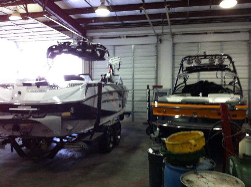

            I dropped my boat off on sat and my service guy was doing some glass work on a G23.
            He is going to get me a measurement to the top of the windshield today at some point. That particular boat is on the boat mate trailer.
            I also asked for a picture to show the difference in height compared to my boat. My tower folds down and the highest point is 7'6". That boat fits under the 8ft door but only has about an inch at my lake house. The 8ft door there is the opening but the door in the up position sags down a bit when its on the rollers and I lose a few inches.

              This is a G23 on a boat mate trailer. Measurement from ground to top of the windshield is 7'11" to the tallest point on the side of glass. He said there might be another 1" of rise from there to the center of the boat. The pic I think is funny it shows how big these boats are. The 23 is just 1' larger than the supra. Sorry for the bad glare.

                Thanks for the measurements! So say the Boatmate is 8' to the op of the windshield. Would it be say 7'10" or less with a Ramlin? This gives me hope that a new/different tower would fit in my garage!

                  I would say you can hold out hope. I would first measure my 8' door to make sure you going to get a full 8' out of it. Your going to use every inch.
