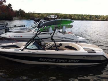

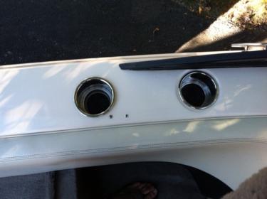

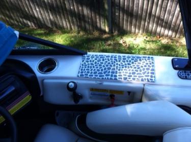

I had the same original tower as you on my 99 SS and I went back and forth on what to replace it with. If the Aviator was available at the time I certainly would have explored it but at the time I didn't like the look of any of the available universal 2 point towers and the FCT3/5 where more than I wanted to spend. I ended up going with the New Dimension tower and I have been quite happy with it. The install was straight forward and it looks great on the boat since it was designed for it and matches the lines perfectly. I think no matter what tower you choose you will end up having holes from the old tower exposed. The front feet on my NDT mounted about 4-6" inches closer to the windshield than the original tower did and the original rear feat were way closer to the back end of the windshield than any modern 2 or 4 point tower would land I think. I thought 4 cup holders up front would look kind of funny and since the the placement of the old holes was a logical place to step into the boat I decided to add some Gator Grip traction to cover those holes. I also did this to cover the rear leg on the driver side to create a comfy arm rest. I may fill these holes eventually but for now I am happy with it like this. On the passenger side I cut in a second cup holder. A 3 -5/8" hole saw works perfectly for the factory stainless cup holders sold on Nautiqueparts.com. Put some painters tape down to help prevent chipping and run the hole saw in reverse until you get through the gel and then switch to forward. Here are a few pics of what I had and what I ended up with.
Old tower holes:
You can sort of see the traction cover:
Arm rest cover:
2nd cup holder added
