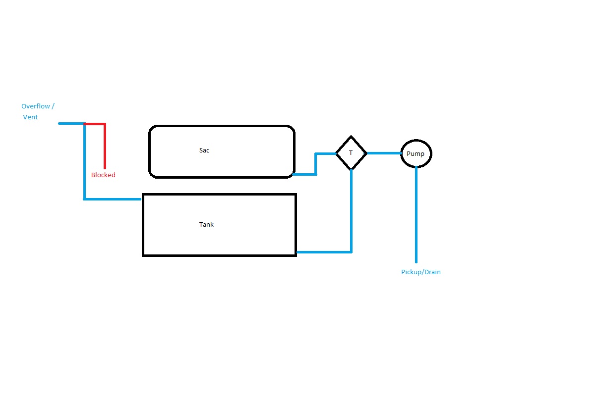

    Hi there, I am after some advice on how to possibly make my ballast system a little more user friendly.
    My current ballast setup is the same for all 3 areas (port, starboard and belly)..
    Pump to T valve
    T valve to tank, with factory overflow/vent
    T valve to sac, sealed.
    (there is a T connection on the vent line where I believe the sacs used to vent but have been blocked off so that the sacs can fully drain)
    Here is a diagram so we're all on the same page.
Name:	Current Ballast.jpg
    Now the issue I have with this is, when cruising to our boarding spot I start filling the tanks, but I need someone at the back to pop the hatches to make sure the valves are set to tank, then once I see on the gauges that they're full, I need said person to re open the hatches and switch the valve to sac, then I need them to stay there an monitor the capacity of the sac.
    And it's the same when emptying, I need someone to keep an eye on the sacs and once empty to flick the valves back over to tank.
    My only thought is to replace the T valves with motorised units controlled at the helm and have the sacs vent through the hull, but with a check valve in place so they can drain completely. The problem I have with this is it would be nice to fill the sacs first all the way and then I can use the gauges on the tanks to adjust the level (we often ride with belly sac/tank full, and rear tank full sac 1/2-2/3 full), and with the sacs overflowing into the same overflow/vent line as the tanks then any overflow from the sac could leak into the the tank. I don't particularly want to drill more holes in my boat.
    I don't like the idea of deleting the T valves and overflowing tank into sac as this leads to either not draining the sac completely (vented) or imploding the factory tank (sealed).
    Has anyone setup a similar system with any success?

      Thanks ryan,
      But if you put a gravity loop in the factory vent line, and T the sac vent into it on the downhill portion then couldn't tank overflow water enter the sac?
      My most recent thought would be to run the vent hose from the thru hull straight up, and fit a Y piece with both tank and sac hoses looping up and over at the same height, then neither should affect the other.
      edit: I think we're basically talking about the same idea here just explained differently.
      The reason the tank may be empty, would be, I like the idea of having a vent on the sac, like you say, listening for the overflow, flip the valve then watch the gauges, this way you can have the system not entirely full and know exactly how full you are from the helm.
      Also do you orientate the sacs so that the fill/drain hole is towards the front of the boat on that slight downhill section of the tank?
      Mine are currently spun around and fill/drain from the back, and even with them sealed, sometimes they wont suck dry.

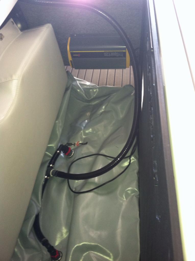

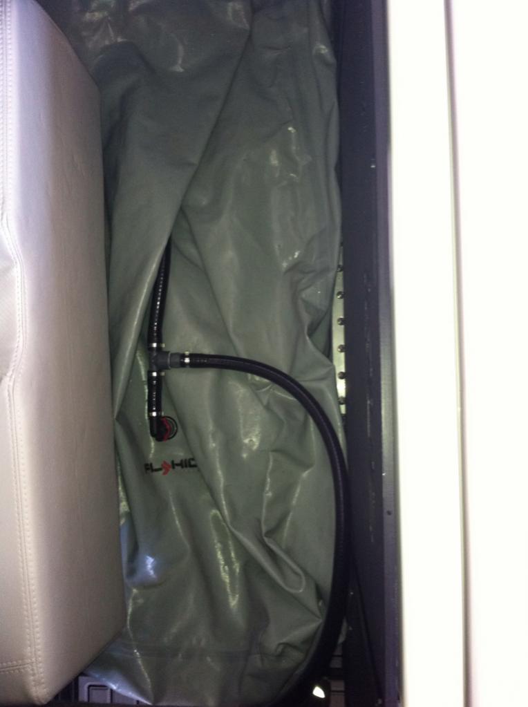

              Possible? Yes. Likely no. Your extra sac hose gets raised high also... So gravity loop after the T on that sac overflow line also.
              Fills from the lower front. Overflow comes off the top in 2 locations. I'll post some pics.
ID:	367783Click image for larger version

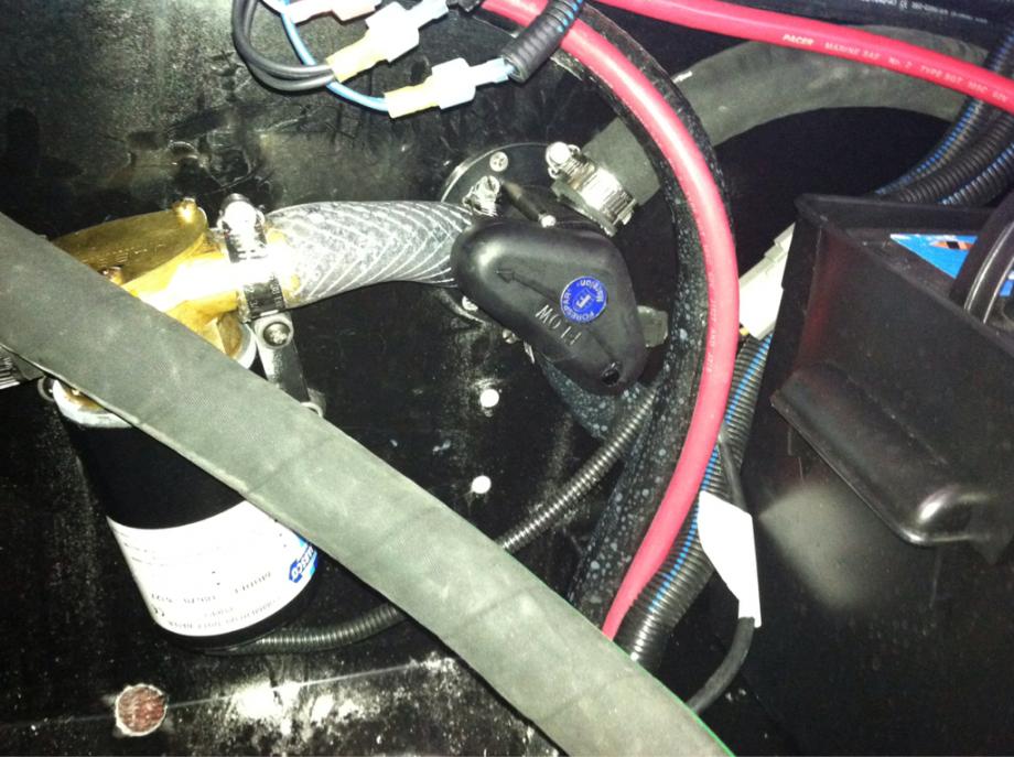

                  And my valve setup
