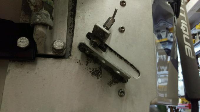

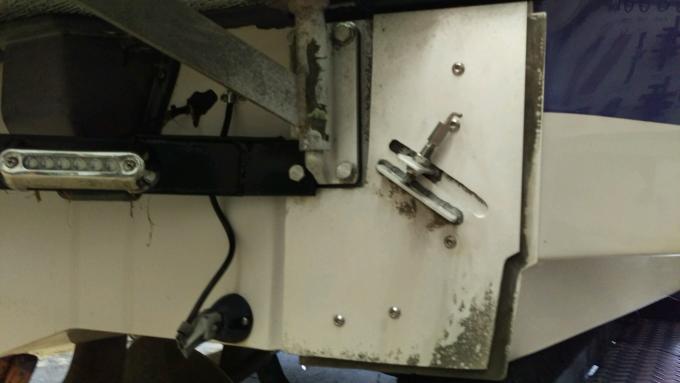

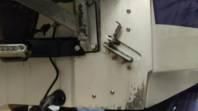

                        So here are a couple quick pics... I could not fully extend the plates because it's sitting on the trailer. Basically its a 3 layer system of aluminum plates. The plate closest to the transom has threaded inserts flush mounted through the backside and is through bolted through the platform brackets. The inserts are smooth on the outside and act as the alignment sliders for the the middle plate. The middle plate floats in between the the inner and outer plate. It has long parellel slots cut into it at an angle that slides them out and drops them down at the same time. The outer most plate acts as the reinforcement for the slide. Now for the sliding mechanism itself is very easy. A stainless spring loaded indexing pin that allows you to lift, slide, and lock with one hand all in one motion. Let me know if you guys have any more questions.
                        First pic shows the locking mechanism and different levels of extension. 2nd pic is fully retracted. 3rd pic shows as far as i could go out because of the trailer, but if you look at the indexing pin its not retracted through the 2nd hole yet.

                          Do the plates bolt behind the swim platform in place of the spacer? Where did u get the locking tabs and how is it bolted to the extendable tab?

                            Yes it replaces the spacer. The aluminum tabs are tig welded on the cover plate and the slider plate. A hole is then drilled for the threaded indexing pin to have a jam nut on each side of the plate to lock it in place and give it the right depth for the pin to lift and lock.
