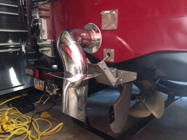

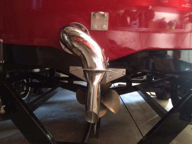

    Just got it done. Fit perfect on my 2012 210.(for 2014 model 210's)

      Do you lose the functionality of the Hydrogate?

        no, it clears the gate in both directions by 1/4.

          How was the install? It looks like the hydorgate clears just fine, and looks like it fits just as well as it does on the 2014's. I know that Nautique Parts has them for $795 but the list them as only to be used on 2014's. I have considered doing it anyway even though its almost twice as much as ordering a FAE since I don't have any center platform bracket on mine and the teak platform moves a lot especially since it has been spaced further out to make room for the NSS and I would have to get something custom made bracket wise to clear the ladder I have or use the transom loop bracket. The surf pipe would also obscure the laser etching on the hydrogate less than the FAE bracketry, which might get my wife to approve it since I have already covered up part of the Byerly signature on the back with the NSS.
          Is the metal flange of the surf pipe bigger than the old flange? If its the same size it looks like it might work on my exhaust as well, although if you look at the bracket it looks like its further away I know that the transom loop is actually offset to starboard a bit on mine.

          Who did you get yours through and did they give you any trouble getting it for a 2012? Have you been able to try it out yet?

            install was not that bad. two people would have been nice for the hardware. one to hold and one to turn. you have to drill new 1/4 holes, because the plate is larger and hole spacing is not the same. the bigger flange will cover any marks you make trying to get old pipe out. you have be quick with the 4200, it sets up fast and you have a lot to do quicky with the hardware, screws, and backing plate. i have not used it yet , but i am betting it is quiet because the muffler is still on boat. The 2014 do not use a muffler when they have this pipe.

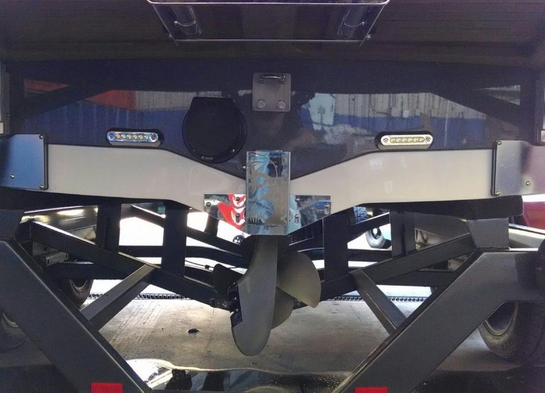

                Larry at FAE got me mine for half that price. See photos installed on 2013 230. I had dealer install (to ensure PCM warranty compliance) and they charged me 1hr labor. I've installed myself on a malibu with wedge, and the nautique install is much simpler. Just another option. FAE was very helpful, took custom measurements to ensure a pro fit and shipped very quickly
