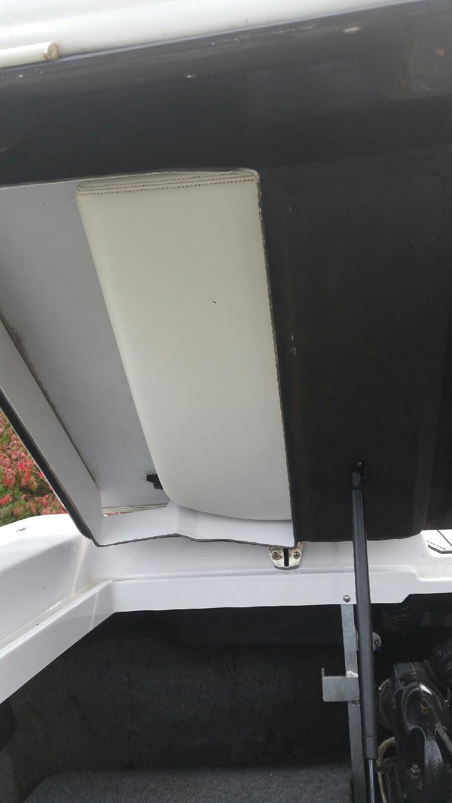

I just purchased this boat an 08 sante 230 and didn't even realize there was supposed to be anything there until reading about upgrading my ballast. They are missing and i cannot find anywhere to purchase them. Any ideas are appreciated.

Ahh that one. Its just a piece of plastic with a bunch of notches in it that is held to those aluminum brackets, in the foreground I can make out one of the big hand knobs that would have held it in place. If you can't scare up the originals or some to copy you can probably template it pretty easy with some cardboard then cut some starboard or other suitable material to fit. Probably cost a couple hundred bucks for the material though, if you use starboard if you can find the stock sheets in a size the fits it could save you a bit.

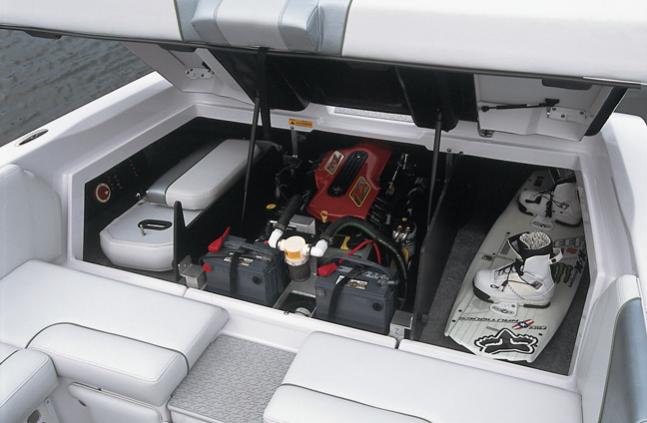

Edit: I found an image that gives some impression as to what they would have looked like.
