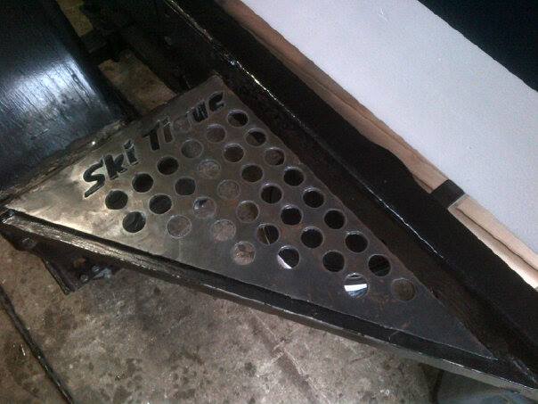

    With the snow melting I was finally able to get the CNC Plasma setup in the driveway and cut some new trailer steps.

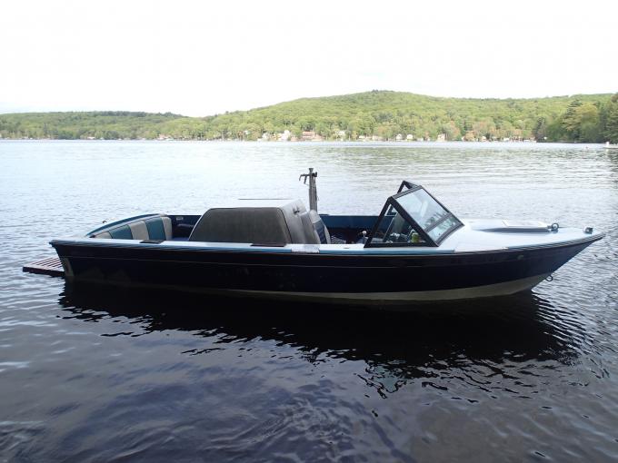

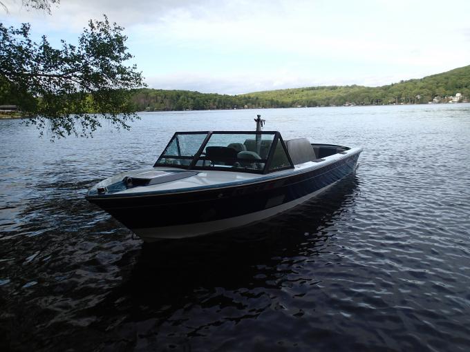

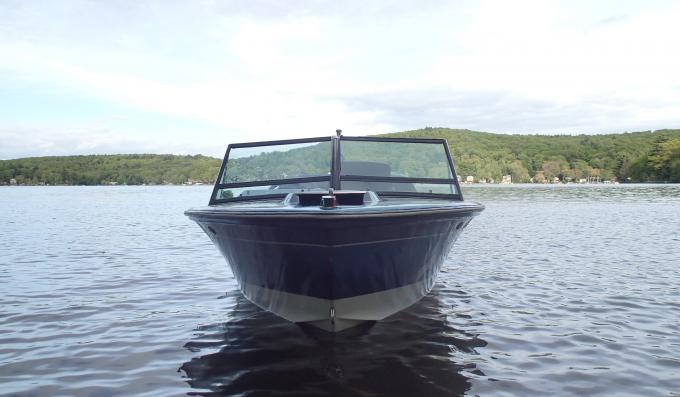

            Here are some pictures from yesterday's lake trip:

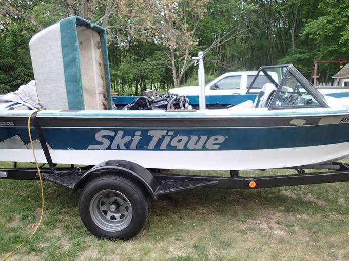

              Got it lettered last night. Not to bad for $17 vinyl, a laptop + projector & a x-acto knife.
