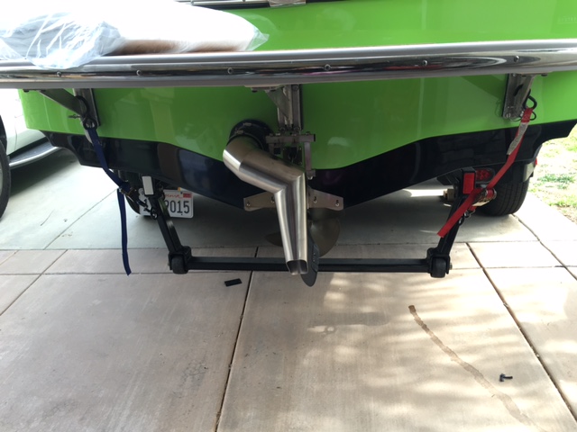

      Originally posted by Jeff88 View Post
      Old thread here.....is adding the surf pipe to a 2014 as easy as bolting it up? Thinking about adding to my 2014 230.
      Not really, but it's not that bad. I installed surf pipe on my 2012 210. Your boat might be different, But if it's anything like mine (with muffler and traditional flapper), you have to remove the flapper, and then the old flange. To remove the flange, I had to cut it into four pieces with a reciprocal saw and break the pieces out. Removing the first piece is the most difficult. After that, they come out pretty easily. Then you have to scrape all the old adhesive off. After that, fitting the surf pipe to the muffler is a bit challenging, but not bad, but the holes of the surf pipe will not match up to the holes of the old flange (at least mine didn't) so you have to drill new holes. After all of that, then (after adding marine adhesive,sealant) it is as easy as bolting it up. With a helper, it took maybe 90 minutes. Again, your boat may be much easier, but this was my experience.
      But it is totally worth it. With muffler and surf pipe, my boat sounds like a sewing machine. And if you surf, surf pipe is great for displacing the fumes so the rider doesn't deal with the them.

                yep,... also added a 2014 210 surf pipe to my 2008 210 SANTE... same procedure as above... before you start... my 2 cents... read some articles on drilling through gel coat if this is your first time doing that
