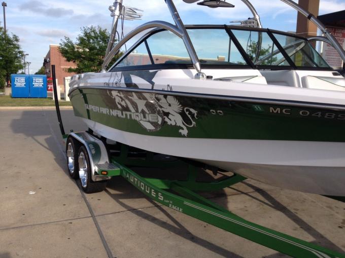

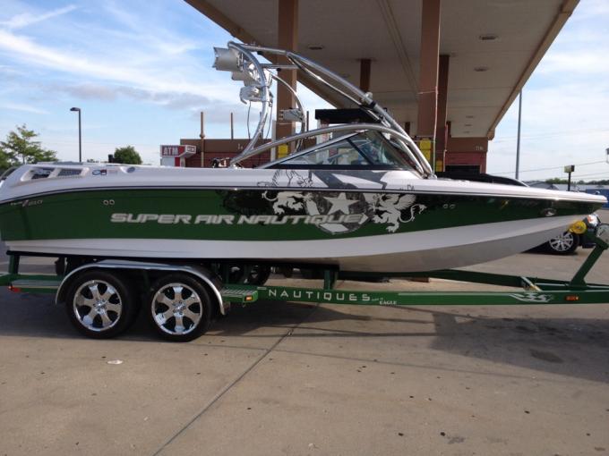

          Have any pics of your Phoenix? My 08 is sitting on a tandem tricked out Eagle that I am not exactly in love with. The Yraiker has sat in the garage probably more than 75% of its life as boat sits on a lift all summer.
