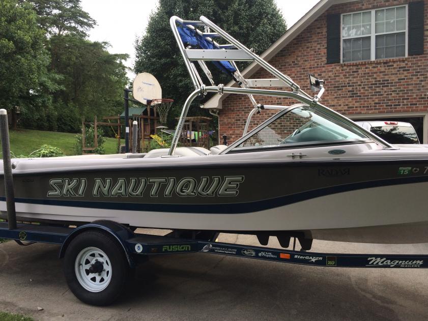

                        that is the boat i was thinking about getting, and trading the trailers. Because of the tongue on that trailer being a Huge A at the front it will not work for the garage that i want to put it in. I was thinking that If i could swap trailer. (also newer, better for skiing and a few other details). I cannot swing for a SPORT200 at this time

                          Now I'm following. Yes, that trailer would be a pain. It would be longer than necessary without a swing tongue, but I bet it would fit in a 26' deep garage with the platform removed. I have a 19' bfn in a 23.5' deep (inside) and it just barely fits. It predates the swing tongue and the platform isn't removable, so I bet it's roughly the same length as a 206 would be.
                          Either way, I would not count on a trailer swap with your SAN working out for either party.
