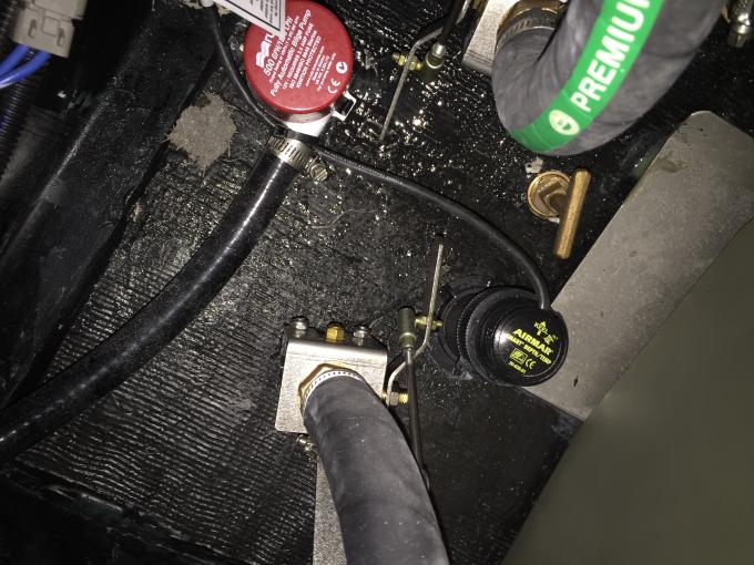

You are correct in assuming that check valves will not work because the pumps are bi-directional. This also rules out most off-the-shelf valves as they do no support bi-directional flow. The "fix" is a system that automatically closes the ball valves when no pumps are running (which is what pmellis is referring to). This system is retrofit-able.
Jeff, the Mussel Mast'r is a ballast filtration system for Quagga and Zebra Mussels.
Yeah, I know that's what the Mussel Mast'r is for. I was saying that that might be what pmellis saw and thought was valves. Adam, are there automatic valves on all of the 2015 boats? If so, that's great!I own and operate Silver Cove Marine, which is an inboard boat restoration, service, and sales facility located in Mooresville, North Carolina. We specializes in Nautiques and Correct Crafts, and also provide general service for Nautiques fifteen years old and older.
From an engineering standpoint I'd prefer a passive solution like an AS loop if possible vs electric valves. Introduces yet another item into the system and increased cost, another winterization item possibly. Also wouldn't want anything that adds time to the 7-9min fill times, not sure if it does.2019 G23 450

Hey Ryan,
Unfortunately traditional AS loops do not work because of the bi-directional flow in our system. There are solenoid operated AS loops but they are not very reliable. The system uses the current ball valves so there is is no added time to the normal fill/drain cycle. If for some reason a component were to fail then there is a quick/easy way to manually open or close the valve still.
Sorry for the misinterpretation there Jeff! It is standard on 2015 G's built after Jan 1.
Thanks for clarifying Adam, no doubt if you guys do fix its gonna be done right.2019 G23 450
