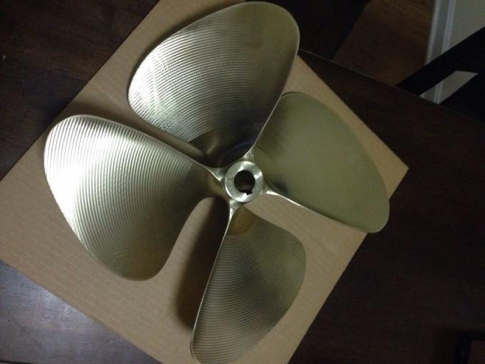

                    #39

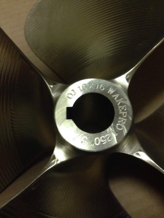

                      #40
                      OJ 16x16

                          Ok, 16x16. Starting to edge up against the capabilities of the 550hp with this prop, but I love it. Drops RPMs massively for nearly the same performance.
                          16x16 performance specs (full gas, 4 onboard): top speed 43-44mph at 5400rpm. Full 2850lb OEM Ballast + ~500lbs, 23mph NCRS 5 3200-3300RPM, little slower launch than 16x15, but not struggling. 23mph no ballast ~2950rpm.
                          Today surfed my standard 11.6mph, 2850+500+~800 at only 2750rpms.
                          So what's the "best" prop?
                          If you want or need to go mega extreme... 2850 + another 2000-4000lbs(especially at 22-24mph speeds). Gas and RPMs be ****ed: get the 16x15 and set new limits. Pros and true wave crazies fall info this category.
                          If you keep your ballast roughly 2850 + 2000 and under, or gas savings really matter to squeeze and extra day of use before you need more gas.. 16x16 for great performance, RPM reduction and significant gas savings.

                              Joe, perhaps it was 100% full gas and 4 folks onboard... Could have also had a little more ballast too. I think the 16x16 drops RPMs another 50-100ish on average over the 16x15.5.
                              So, for an "ultimate" 550hp G prop, it'd have to be the 16x15. Considerably better performance and some fuel savings over OEM prop.
                              The 16x16 would be the "Eco" upgrade: slightly better perfoamce than OEM and considerable fuel savings.
