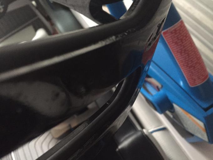

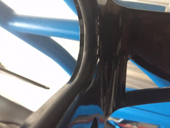

    The paint and/or coating on my board racks (Both) is starting to bubble up and flake off.
    I sent a few pics to my dealer. My service manager sent the pics to Nautique and they responded back with "its garden-variety corrosion, not covered".
    The aluminum surface under the coating is nice and clean and smooth, not corroded.
    The paint is not corroded nor does it look bad. It is just releasing from the metal.
    It seems to me that the cleaning and prepping before application would be the problem???
    Our boat is only 10 months old with 60 hrs. this seems a little pre mature even if it was corrosion.
    It also seems crazy that it wouldn't be covered no matter what. I mean less than 1 year old, really?!
    I do not have a problem taking responsibility if I tear something up or do something wrong, but I don't see how this has anything to do with me.
    We are not in extream conditions and my boat is fully detailed after EVERY usage and stored in a dry storage. NEVER left in the elements.
    Should I take this on the chin or contact Nautique for more assistance?
    I don't mind hearing opinions, but real warranty experience is what I am after.

                      Your Location says League City. Is your boat used in Salt Water? Is it a Salt Water edition boat?
                      My boat is used on Lake Conroe, Lake Dunlap, and Clear Creek.
                      Clear Creek is brackish.
                      We do not have a coastal edition, however, I was told that it would not matter either way.

                            I guess I am crazy here for thinking that the board racks should be able to hold boards and not get torn up doing it. LOL
                            I spoke with the owner of my dealership today and he contacted Nautique.
                            Looks like Nautique gets these racks from Roswell and they are actually the ones denying the claim.
                            Also, I am getting a different story now.
                            I was originally told that the paint was coming off due to corrosion and that is why it is not covered.
                            I told them that the racks were kept clean and that there is no corrosion on the outside of the paint or on the metal, so how was the paint releasing from the metal?
                            Basically, if prepped and painted correctly, how does water ect get under the paint? It would need a way in.
                            Now they are telling me that the paint was just chipped off from a board hitting it.
                            2 things:
                            1st -There is a thick rubber liner in the rack that protects the board and rack. I would have to really slam the board into the rack to blow past the rubber in order to hit the paint hard enough the chip the paint.
                            2nd - If you look closely at the picture you can see where there are no scratches, dings, or chips to the paint, but yet it is releasing and bubbling up.
                            Either way, my dealer is requesting that I shoot a quick video for them to send to Nautique so they can go back to Roswell.
                            I have to show in detail where the paint is bubbled up and if I touch it then it will flake off.
                            Ill do this tonight and let you guys know what they say.

                              If you can show that it is bubbling and releasing from the metal, then it truly is a coating failure. At work, we have several metal parts powder coated for us and if the coater does not allow the parts to dry completely and some of the cleaning agent (removes oils and grease) is still on the steel when the powder goes on, it will still cure, but not adhere properly and then will start to bubble. These bubbles, when you get an edge opened up will peel completely away from the steel and then if exposed to moisture will peel away in sheets. If there are areas where it is clearly bubbled and there is no finish removed from the edge, they should clearly know this is a failed coating.
