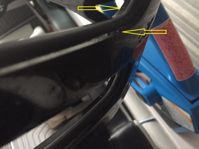

    Originally posted by Dandy21 View Post
    If you can show that it is bubbling and releasing from the metal, then it truly is a coating failure. At work, we have several metal parts powder coated for us and if the coater does not allow the parts to dry completely and some of the cleaning agent (removes oils and grease) is still on the steel when the powder goes on, it will still cure, but not adhere properly and then will start to bubble. These bubbles, when you get an edge opened up will peel completely away from the steel and then if exposed to moisture will peel away in sheets. If there are areas where it is clearly bubbled and there is no finish removed from the edge, they should clearly know this is a failed coating.
    On a side note, it sounds as if your dealer is stepping up and helping you to get this covered under warranty if at all possible. Kudos to them
    Here is the pic with arrows pointing to the bubbles, you can see there are no chips, dings, dents, ect...
    After speaking with the owner this morning, I think they are stepping up for sure.

      This really sucks. I feel bad for your predicament and hope the dealer comes through.
      A friend owns a powder coating business. They coated some cast aluminum chairs and tables for me where the original coating had broken down and was flaking off like crazy. They suggested a powder primer before applying the final powder coating and thorough sand blasting. Said it should last 10 years where just PC would only w/o primer last 2 or 3. I followed her advice and had them primer and they've been bullet proof. I live a few blocks from the ocean and the furniture gets hit with my sprinklers every few days, too. No sign of the coating breaking down after 4 years.
      If they won't take care of it, I'd work with a local powder coating shop to get them done properly.

              I Actually took a video of the sides of all of my wakeboards and surf boards to show my dealer that there was no damage.
              My point was that if I hit the rack hard enough to blow past the thick rubber gasket and actually chip the paint off of the rack, the board would show a ding.
              I also asked the to explain the bubbling on the outside of the rack.
              I'm waiting to hear back.

                  Well, they are sending new board racks to my dealer.
                  The owner of my dealership contacted them and got the claim reversed.
                  He forwarded me the email and it stated that they reversed it because I have not had the boat 1 year yet.
                  They sent a call tag for my current racks, so If you have an order in for a new Nautique, check the racks for touchup paint before you take delivery! LOL
