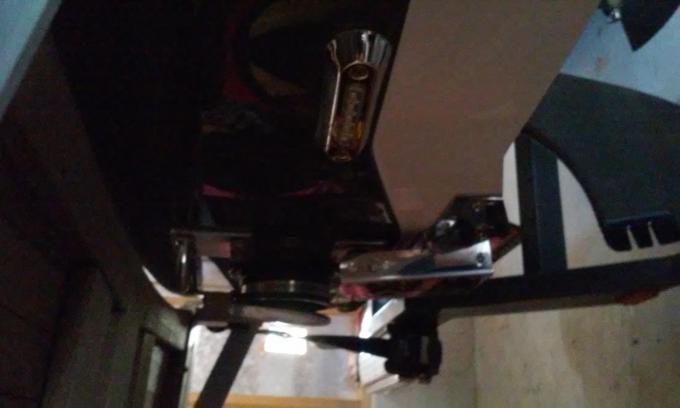

                  Mine has the useless center u bolt in the back that if used puts the trailer straps at a serious angle which I am sure has some impact on the ability of the boatbuckles that my trailer has. After using it several times the retracting mechanism gives out in the boatbuckle. Rather than continuing to replace them I just use the platform bracket like others do which does make me a bit nervous so on longer trips (300 miles or longer) I use the u bolt for those. Its kind of dark but you can just make out the bolt above the flapper and the strap to the platform in the picture its kind of dark but that's as much light as I could get.

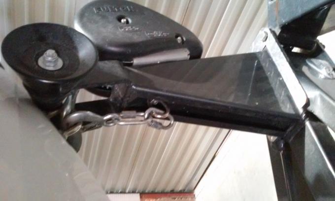

                  For the bow eye I added my own "chain" with a re-used winch strap hook I saved when I replaced the strap and a stainless steel eye nut I replaced the nut on one of the winch mounts with. The weekest link in my system is the eye nut which has a working load limit of 1,160lbs, there are 2 3/8" quick links with a working load limit of 2100lbs. I don't intend for them to pull the weight of the boat just keep it from sliding off the trailer if the strap fails and provide a little more resistance to becoming a projectile in an emergency. It was the best compromise I could come up with based on the real estate I had to work with. The tubular arm starts bending right where I would have put a hole in it and if I went lower in the winch stand it would have been a pain to bolt in and the chain would rub the paint. Its just long enough to work well and short enough to stop any movement quickly.
                  Not sure why its insisting on rotating the pictures, the look fine on my computer.
