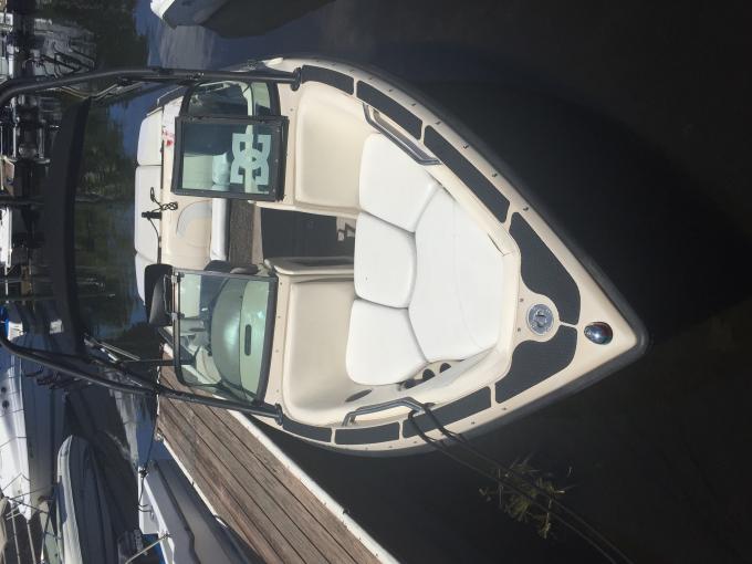

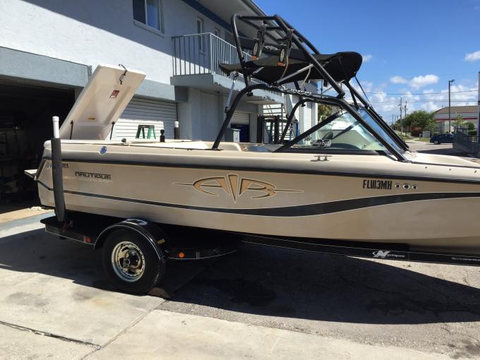

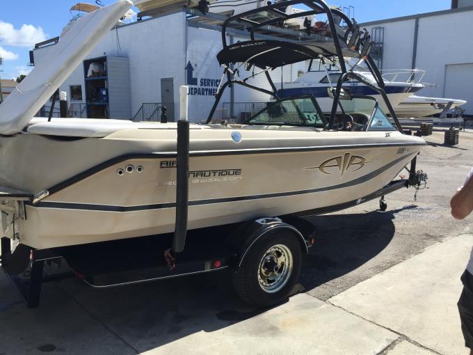

              So the trip back from florida was stressful but we made it back in one piece. After some research on this forum, I went to the auto parts store and purchased 800, 1000, 1500, and 2000 grit sand paper. I have made it through the 800 and 1000 so far. I wish I would of started with compound first to see how that did because I feel like the sand paper may be doing more harm than good. I think once I get past the 1500 and 2000 grit it will look better. I did find that the ground cable on the batter was broken off and a small connector was fastened to it. The ground is screwed on to the small accessory bolt instead of the actual spot where a battery cable would normally be mounted. The carpet is slightly stained. I am first going to try pressure washing, If that does not work I am either going to replace it or go with sea dek. Have not yet decided. I will hook it up to the fake a lake today and take a video of the boat running to see what you guys think. I was able to get the docking lights working but everything else is still giving some trouble. I need to get a new cover for it. I saw that you can get them off nautique parts in sunbrella. Does anyone have experience with these? Do they hold up well? Are they a good fit?
              Here are some pics from the trip back.

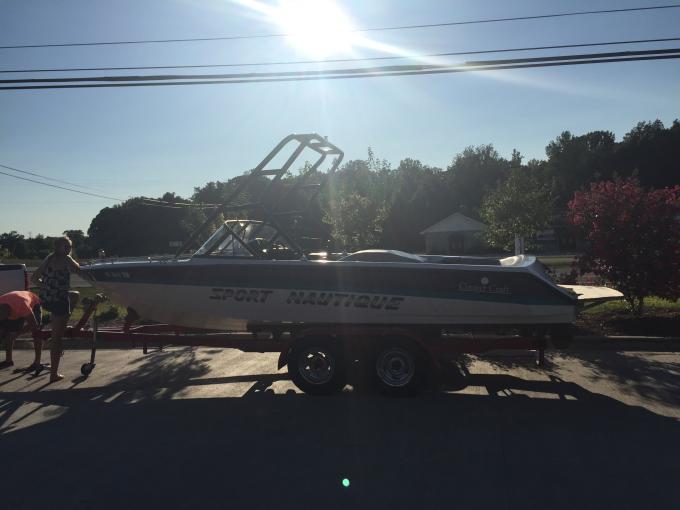

                Sold my pristine Sport nautique today to free up funds to restore this new super air nautique. It was very hard to let it go but I am very optimistic about this new project!

                  dangit.... I wish I would have know you were going to start with 800... there is a thread in the appearance section that discusses exactly what you said and that is to start with the highest number (less coarse) stuff you can... I agree with you in that I would have tried 3m heavy rubbing compound first, if not you are just buying yourself maybe many more steps (800-->1200-->1600-->2000--> compound--> polish--> wax) vice trying the compound and then deciding it wasn't "enough" to cut it down to what you wanted it to look like.
                  Glad you got it back home okay and that some of the things are looking to be pretty simple. Always start with the simple solution first.
