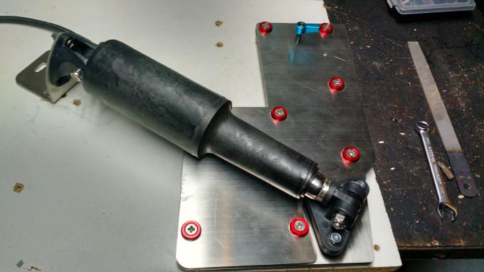

    OG 210 owners might be interested in this build of mine which is still in progress. 3mm stainless plates, 2.25" extension

      Simplysanj,,, You have some great ideas. Show us more of this beautiful device ^^^. Have you mounted it? What does the surf wave look like?

        I am working on it now, hope to get it installed in a week or two. I will start a new thread on the build. It will be open source so anybody can download, cut, tool and install. Be warned, it isn't a beginner's project.
        Will be installed on a 2002 SAN TE.
