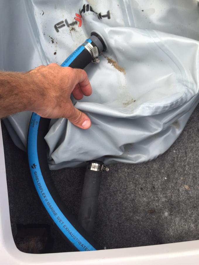

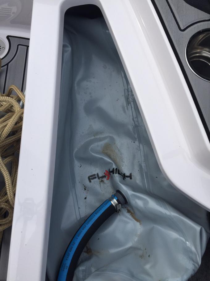

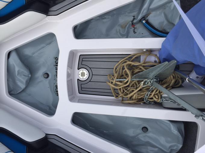

    I have the piggyback in the bow. Works great. They ran it off the vent line for the belly tank. Just fill it through the ballast screen so the pumps run longer. Adds 500-600 pounds. If I get a chance tomorrow, I will take some pictures and post them.

                          Here are the pictures of the IBS.
