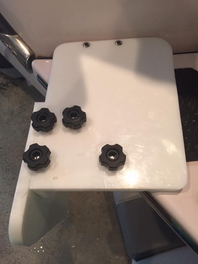

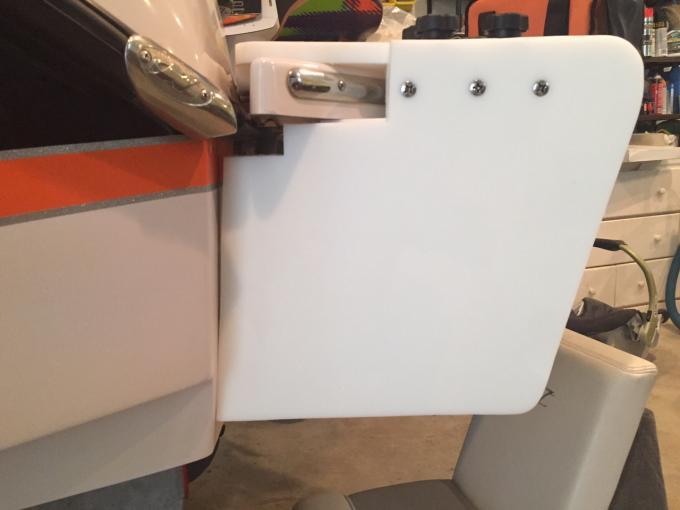

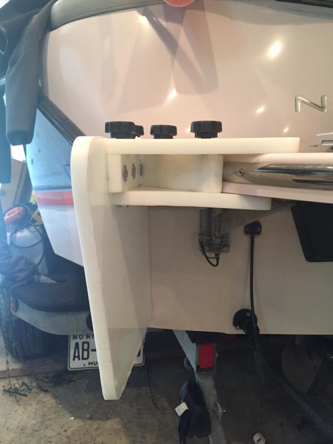

                  I have about $80 in this setup made with all stainless and 3/4" HDPE. Works great can surf with evenly weighted on 2005 210 SANTE. Takes less than a minute to install and remove. I went through several iterations of plywood models before I got it right.
                  2005 210 SANTE

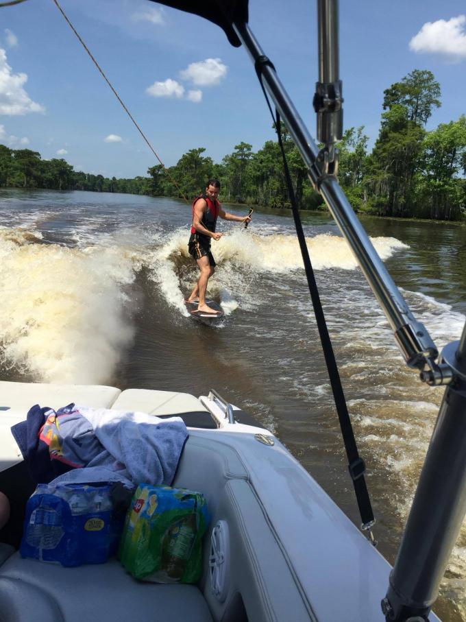

                          I read through that one, and i saw where nr2041 was showing he had factory ballast plus five people. i would guess setup to be about equal to that, but my wake looks nothing like his. see photo. (sorry for the steam, needs an impeller)

                            if you look at the last pics I posted of the wake in the other thread, I only had three people in the boat, I have factory hard tanks, no additional ballast, 10 mph, we found over the weekend that speeding up made pocket longer but not as tall, and the more level we could get the boat the better the wave was, sometimes had to have everyone sitting on starboard side to ride port wave, we tried several combos for weight, from 8 people and factory to 2 people and 800 lb sack in the floor, nothing really changed the wake all that much, I am really please with just hard tanks and a few people in the boat, I posted pics with measurements and materials used for my build in the other thread, so check them out if your interested
