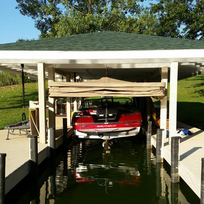

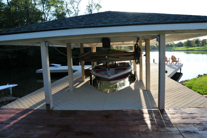

Here's another shot of his boathouse.

^^^Holy crap thats a long way down!!!I own and operate Silver Cove Marine, which is an inboard boat restoration, service, and sales facility located in Mooresville, North Carolina. We specializes in Nautiques and Correct Crafts, and also provide general service for Nautiques fifteen years old and older.

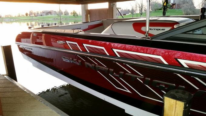

My cradle that I had a few years back cleared the dock with about 3-4" on either side.... and I had firehose as padding all the way around. If I knew a storm was coming - I would be sure the cradle sides were even with the fascia board and then I knew there would be almost zero movement..
Water is at a more normal level now.

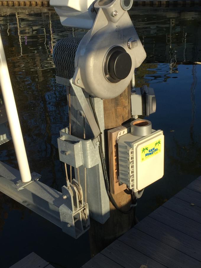

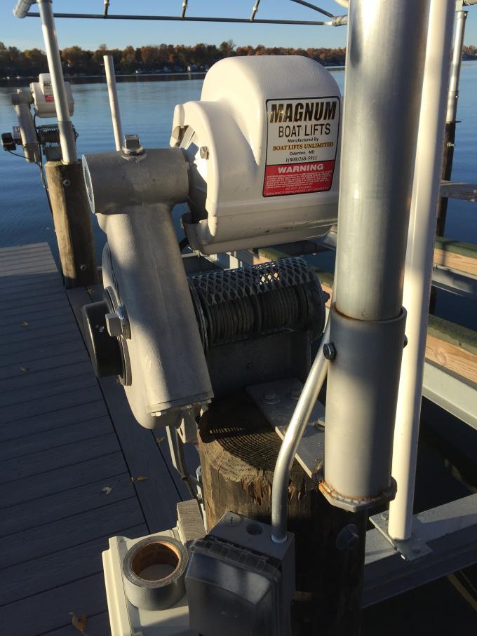

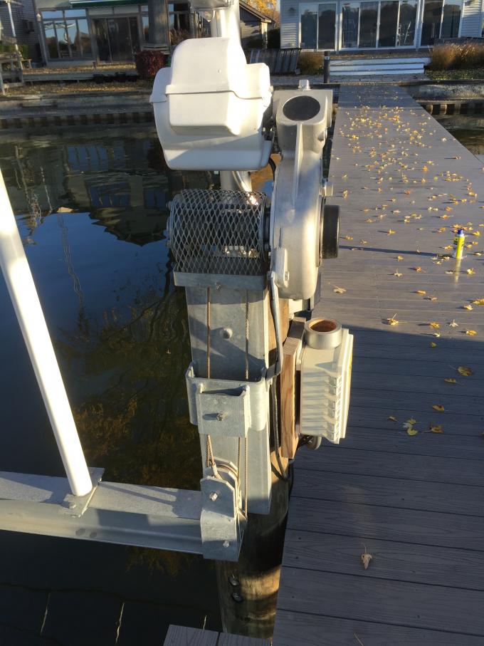

I like lifting by the rings, very simple, no bunks to scuff the bottom or possibly cause blistering from constant moisture, easy access to the bottom for cleaning. The only real downside I see is that you have to keep weight on the cables to keep them from getting out of place where they wind. I have no problems but once in a while someone will be trying to help and unclip the cable and lift it and the weight up giving it lots of slack. Mine is also a little slow, takes around a minute to lift or lower. A limit switch (which I don't have) would be a nice safety feature, one of these days I am going to get distracted and forget it is going up and forget to stop it. Wind has never been an issue, even before the touchless cover was installed. If money was no object I would go with a Sunstream hydraulic lift. They are very fast and have a remote control allowing operation from the driver's seat. here are a few photos of my cable lift.3 Photos2019 Ski Nautique 6.2 arriving soon
