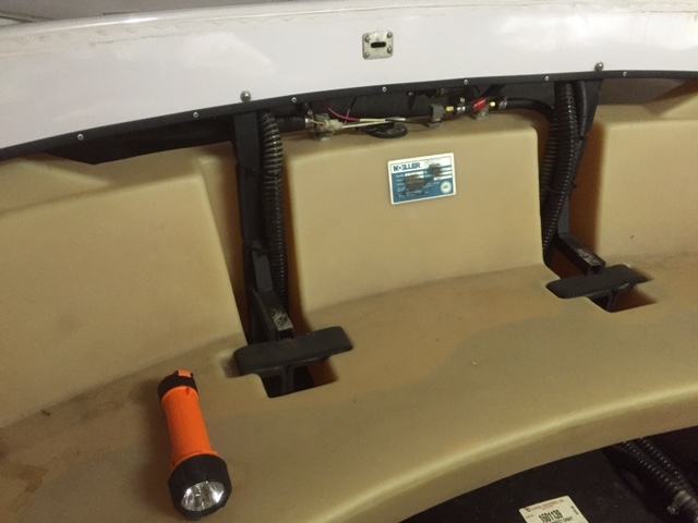

    I have read several post here about this job, and none seem to fit my application. When removing the center floor piece the cable connections are too far away to get to even with the wheel turned all the way to starboard. It appears my starboard ballast tank needs to come out. Couple questions. How hard is this to do? Any instructions out there already? And also what specifically holds the rear seat back in place. It see the bolt through the back wall with the knob, but what hold the ends? Do I need to pull the combing pad(s) to take it seat back out? Thanks for the help. Sam

        They stopped calling them Sports and mine is an AN 216. Direct Drive. The gas tank is under the rear seat and is tall in the back blocking any view or access to the cable connections. It appears as though the gas tank needs to slide forward significantly if not out completely to be able to work under the ballast tank. The ballast tank appears nearly impossible to remover with the gas tank in the way of accessing the hose connections to it. Below are a couple pics to show difficulty of access. Sorry one is sideways but it is easier for you to turn your head than for me to redo! I have all winter now to do this and it just may take me that long. :o(

          It appears you may have some wiggle room with the ballast tanks, I would loosen/remove the retainers at the floor and see if you can move the tank(s) enough to get your hand down there in between them to access the nuts you need to loosen and remove.
