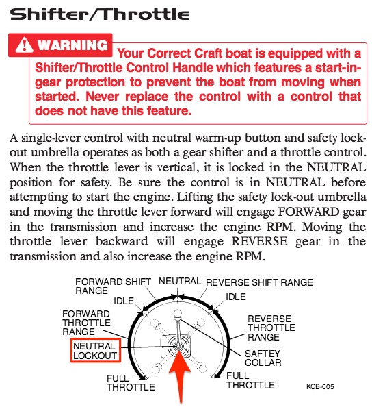

I have a 2005 Air Nautique 226 and don't see how I can rev the engine in neutral. I'm sure it's obvious, but I can't figure it out.
There is a button at the base of the throttle arm. Just press that in and move the handle forward. When that button is pressed, it will not go into gear.
