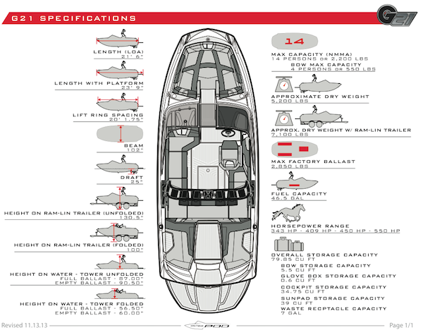

    Does anyone know the height of a G21 w the tower down? With weather forecasted to be cold this weekend, I want to find a warm place for the new boat. Tia.

    I didn't get a perfect measurement, but on a Boatmate tandem axle trailer with the tower all the way down in the folded position, I measured my G21 height at about 8'3".

      This is on a Ram-Lin

        Thats a great document. Thanks Andrew!
