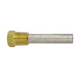

      As for your engine, I would highly suggest to spray it and the transmission down with Gibson Oil each week before putting it in the water. This will keep the outside of the engine, transmission and motor mounts from rusting as much as possible. Sure you can use other things like WD-40 and such but they are not as Superior to Gibson. Find a set of zinc anodes you can thread into your exhaust manifolds. You can thread these into the 1/2" drain plug holes. (Picture Below)
