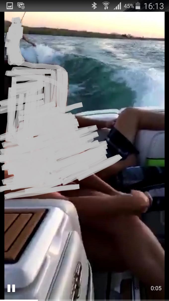

      Yes!!!
      I will let the owner post his videos.
      I saw a quick one and that wave looks pretty good. Very clean.
      Here's a teaser ugly screenshot from the video
