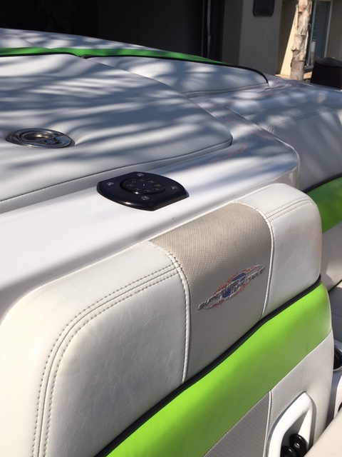

    My SANTE 220 does not have a tow point near the engine? Recently bought it and just noticed it. No other SANTE 220's seem to be missing this that I've looked at. What would you use to pull tube etc.? Heard you shouldn't pull tubers from the tower.

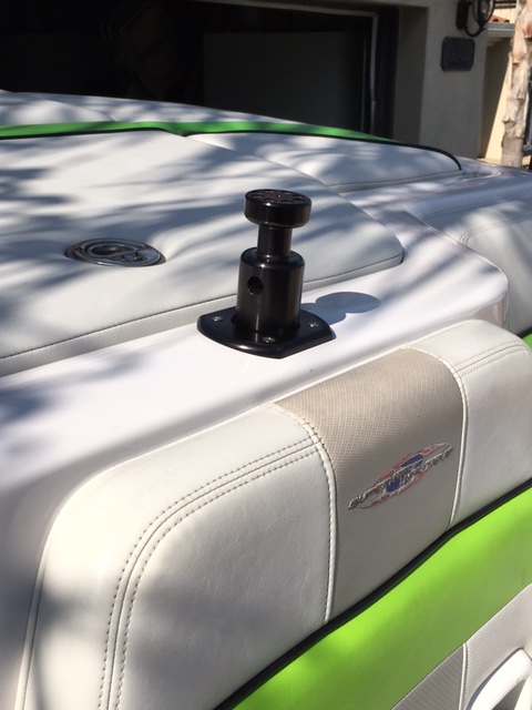

    You should use the pylon in front of the engine. You should have that. Here is a pic of mine. the only difference is that I installed a custom pylon that compresses down to hide when not in use. Search the forums here and you will see who makes them.

              I don't think that eyelet has enough support. I think it would probably cause some stress cracks. Take a look under the engine compartment it's just fiberglass and one small metal rod.
              I assume that the support is there for your tow point in front of the engine. It's pretty simple to install. All you need is a aluminum bar and two U Bolts.
              If you don't want to install it, I think you would be better off towing from the tower IMO.
