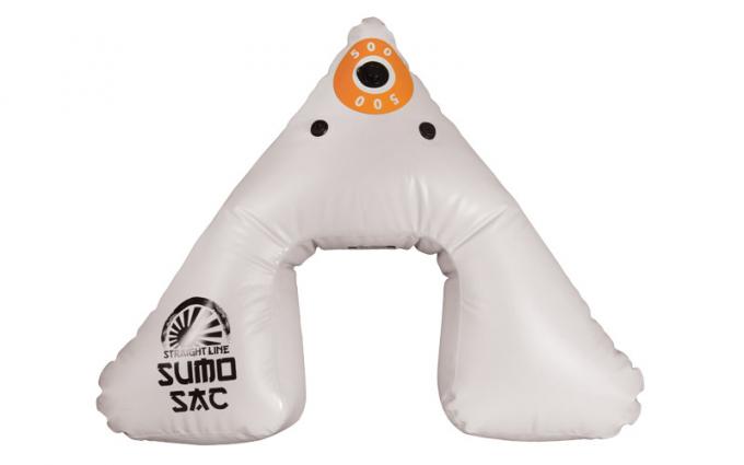

                  Wait, sorry, I've been mixing things up a bit. I said arrow but meant what StraightLine calls "open bow"; a triangle with a bite out of it
                  Like in this pic. Click image for larger version

                  Anyway, think I'll see how the Sumo Max 675 Bow Bag works, if available.

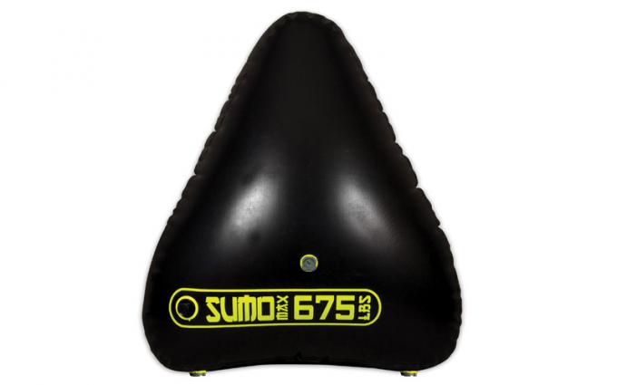

                      Just to make clear, I was (and am) in doubt between the shape that I posted the pic above of, and this one that I'm now planning to get:

                      I wasn't considering the arrow shape, that you posted. Thought it didn't fit. But now that may be an option too it seems.
                      Nice; more options, just what I needed!
