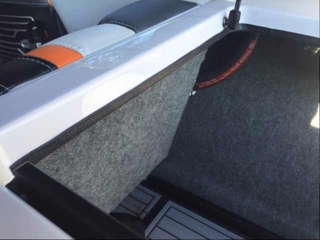

              I ordered 25' of 1/4" Black Edge Trim Lok via ebay (http://www.ebay.com/itm/181909392077) for two boats for ~$25 and it worked out well. The fiberglass width changes as you work your way around the rear hatches, so 1/4" was pretty tight. I simply used taps from a rubber mallet to slowly work it on. You could also consider https://www.zoro.com/trim-lok-inc-fi...25/i/G4163577/ for $68, which adjusts from 1/4" to 1/2", which I think would be perfect.
              So glad I did this, the boards are no longer getting beat up.
              Good luck!

                Saweeet!! Funny I was just looking into doing something like this for my '16 G23. Then forgot all about it and now today I run across this thread! Excellent! I'll be ordering some asap!
                Question....you say 25' covered 2 boats? So 15' should be enough for just 1, correct?

                  Yes, I'd get 13' to be safe as I'm not sure the exact length I used. Make sure to measure the width of your fiberglass around the rear lockers. My 2015 was consistently 1/4" to 5/16", but had a couple of wide sections where I had to cut the back of the edging as it wouldn't stretch that far.
