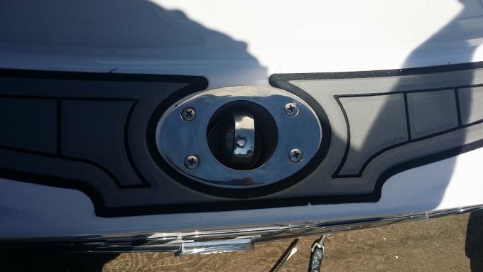

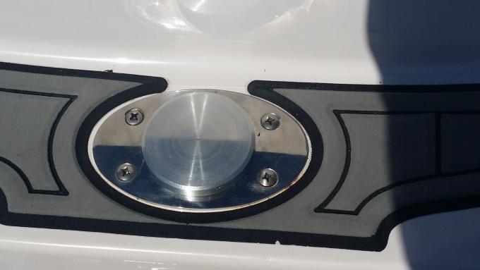

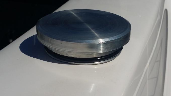

    Second was the rear ski/hidden pole is a direct line for water to enter hull every time you sack the boat down with weight.
    Fix- machine a cap with o-ring. So I fired up my lathe and whipped this out. Click image for larger version

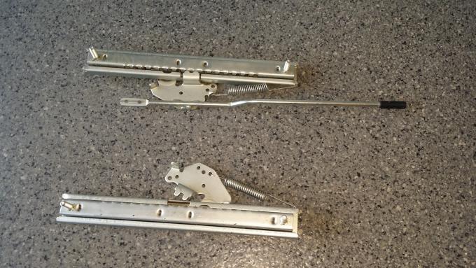

      Third thing I addresses this week is seat sliders that are mild steel.....
      I ordered SS sliders and removed the old ones.

        • shag
          • 2217
          Where did you get the SS sliders? shagit007@aol.com please
          • Outdoorjp
            • Jul 2016
            • 178
            • Carlsbad
            • 2011 SAN team 210
            Great Lakes Skipper.
