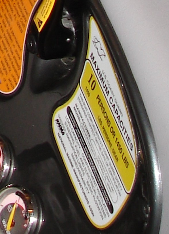

If I remember correctly, all Super Air Nautiques of that vintage said Super Sport Nautique on the placard you're talking about. I'm pretty sure my 2003 SAN said that too.I own and operate Silver Cove Marine, which is an inboard boat restoration, service, and sales facility located in Mooresville, North Carolina. We specializes in Nautiques and Correct Crafts, and also provide general service for Nautiques fifteen years old and older.
I'm wondering if there is an identifying feature that would only be found on a Super Sport or a Super Air that would help me identify it either way...
Yep, it is hard to read, but I found an old picture of my 2003 SAN, and it says Super Sport Nautique on the placard.
They're the same boat. In fact, a few dealers back then used to order Super Sports, and then add options to them to make them identical to the SAN. This was a less-expensive way to get exactly the same boat.I own and operate Silver Cove Marine, which is an inboard boat restoration, service, and sales facility located in Mooresville, North Carolina. We specializes in Nautiques and Correct Crafts, and also provide general service for Nautiques fifteen years old and older.

The confusing thing about 2002 might be that they offered 3 Vdrive models that year: "Nautique Super Sport" ....."Super Air Nautique"...and "Team Edition" So if yours says Super Air Nautique....the graphics just might be the original and you had the Super Air....not just the Super Sport. All three are technically the same hull...just dressed in different clothes....Last edited by Kenv; 08-22-2016, 11:43 PM.
The main differences back in the day between the Super Sport and Super Air were the graphics and gelcoat options. Otherwise you could order a super sport with identical options as the super air. You just wouldn't have gotten some of the gelcoat accents or interior designs that were available on the super air only. The team edition just packages all the essentials in one nice group and gave you different badge. Even Super Air Team Editions had "super sport "on the placard. Same went for the XStars of that era. They were all badged 205v's
