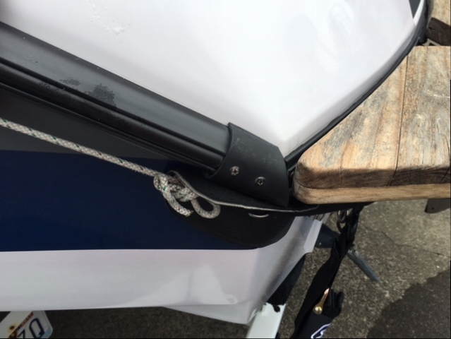

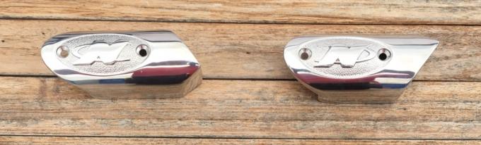

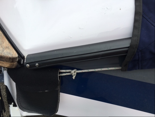

    I purchased a 98 super sport back in April. One of the stock plastic rub rail end caps was missing. I purchased a set of stainless steal end caps with the Nautique "N" logo. I went to install them and quickly noticed that the screws don't line up. My question is is this fix as simple as drilling a new pilot hole and installing the screws? Should I put a small dab of 3M 5200 on the ends of screws? Any help would be appreciated, thanks in advance!

    How long are the existing screws? If they just screw into the rubber rope piece in the middle just pull out the old ones and screw new holes into the rubber. If they are through the side of the hull you may want to peel back the rubrail, seal the old holes with 5200, drill new pilot holes and screw in the new screws with some 5200.

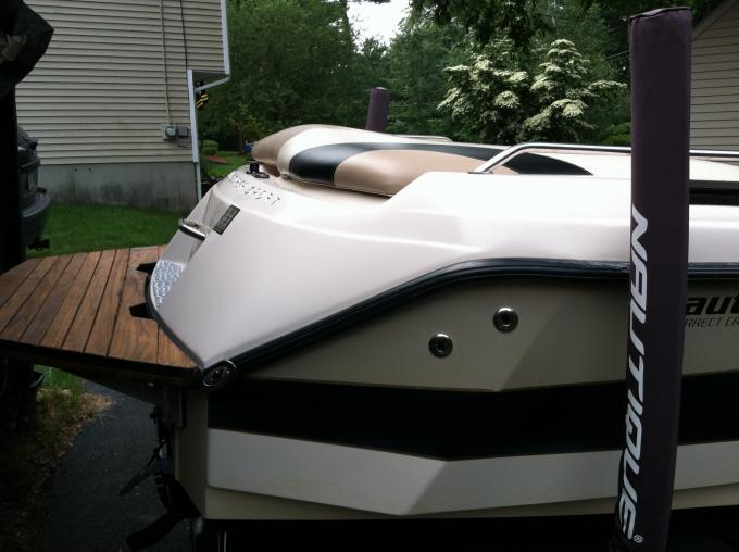

              I ran into this same issue on my 99 Super Sport. I believe the original screws screw into the glass. I think I reused the rear hole, sealed the existing front hole and used a shorter screw for the front hole that just went into the rubber so I didn't have to drill a second hole. It seemed very solid and has not budged in the 4 years since I have done it. Nothing wrong with drilling a new hole but I haven't seen anything that has necessitated it yet so I never went back and did it.
