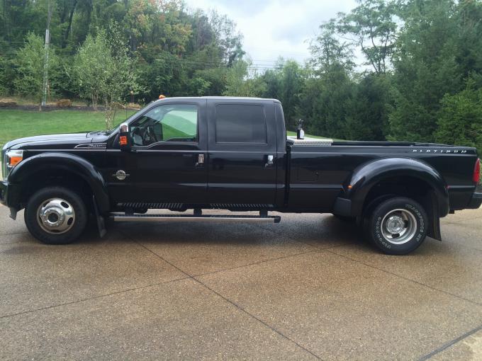

              This truck is going to dealer for trade in two weeks. I would recommend this truck to anyone looking for quality tow vehicle for their G series boat, and as a daily driver. Electric brakes not needed, the f-450's tow and stop 10k without even knowing its behind you. I have to tow every time we ride so this makes it very easy for me. Plus the family is safe, along with everyone else driving around me. This one is at dealer for 39k. PM me if interested.
