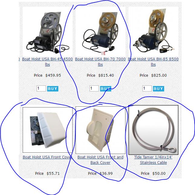

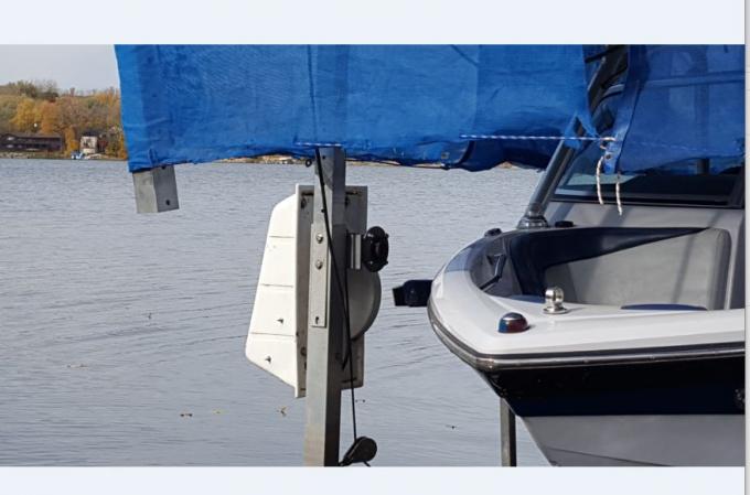

        This is so not about the mfgr...it is about the sales person. Please post a pic of winch and cable? You should have something like this for your weight...while i don't have a 7000 lb one, i have this style on my shoremaster 50120 and guess what...the cable, and motor, etc, are not gonna break...see bottom pic for my set up
        http://www.boatliftwarehouse.com/boa...s/boat_hoists/
        Click image for larger version  Name:	winch.JPG Views:	1 Size:	82.3 KB ID:	504434
