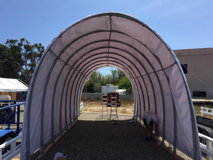

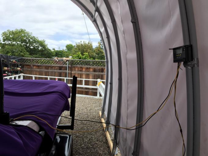

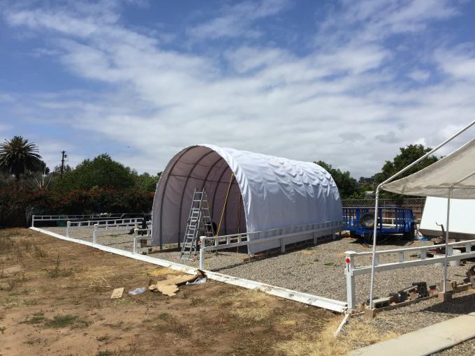

            My boat lives in the barn I built from PVC tubes and a custom billboard tarp, but I'm in San Diego county, so no freezing. I added a solar panel and solar charger to top off the batteries and have a 12V relay timer which runs for 4 days after I plug it in following a trip. I've never returned to wet carpeting. I'm lucky not to have mice / rodent problems, so far (almost 2 years)!

            Doug
