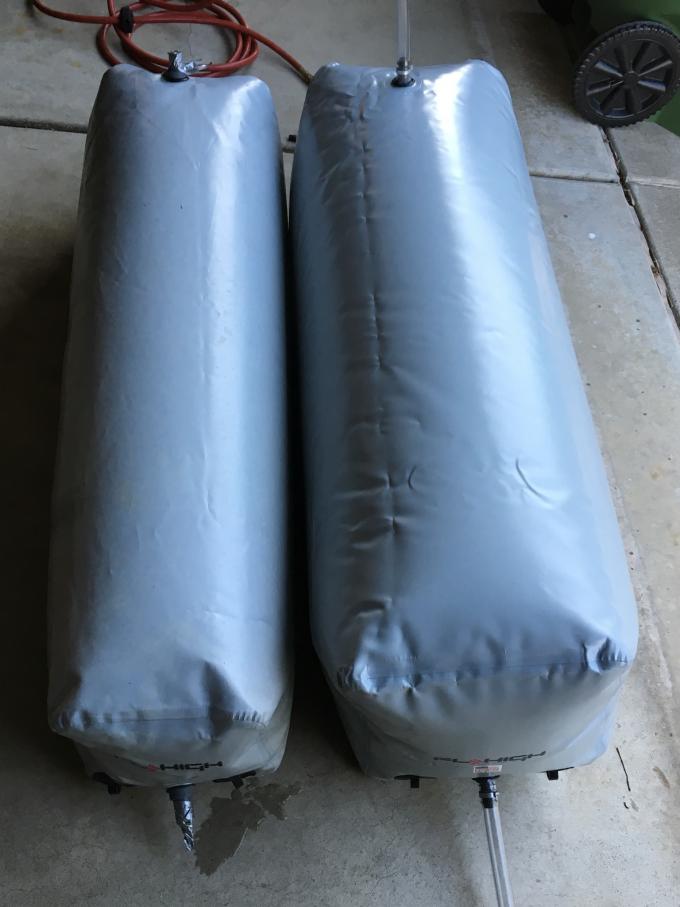

              I wanted to add more weight but didn't want to lose my storage trays so I had some custom bags made that used up all the available space below the trays. As you can see in the picture, the new sacks are much bigger than the factory pro ballast. Pro ballast adds 600 pounds of weight so that's 300 pounds per sack, my new sacks are 450 pounds each.
              I now have a much better surf wave and still have my storage trays in place.
              For my purposes, I did not need to re-prop.
