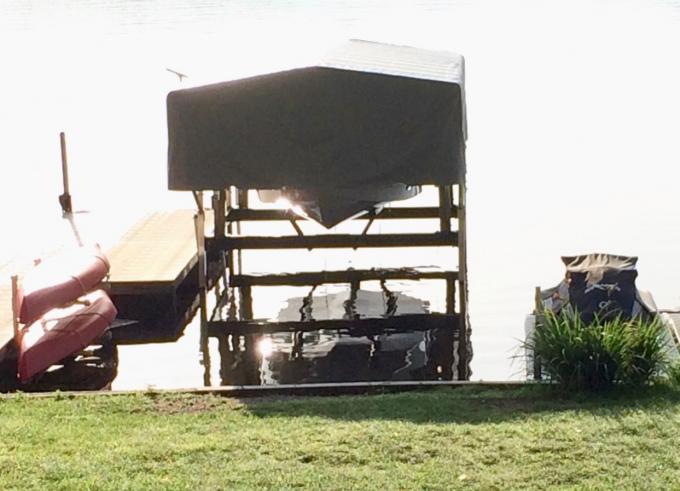

Name:	Andy Phone 1343.JPG
                              The Beach King does have 3 zippers in the back. Their website needs some updating. This is what the dealer sent. They have some way to roll up when using your boat.
                              As for Lift-Tech I did talk with Steve who I think is the owner. Great guy. He did recommend 24 volt and let me know that Auto-Stop will be on DC models this year. He had many stories to tell about towers going thru canopies. Mostly around kids finding the remotes and playing with them.
                              I was going to go with a 29 ft canopy vs 26 ft. 26 would be fine form my G21. Any reason not to go with a 29 foot?
