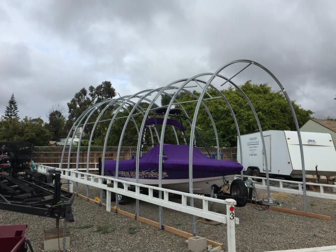

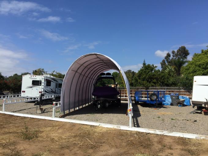

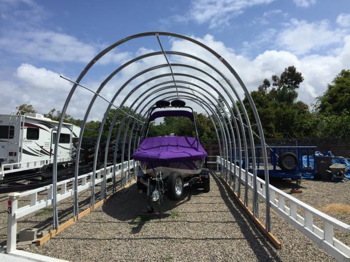

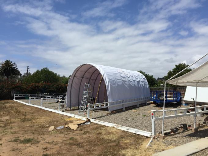

                  To answer your question, my boat barn makes a tremendous difference in keeping the boat clean, dry and out of the sun. With other boats, I'd fought with water pooling on the cover, sun faded gelcoat and other.

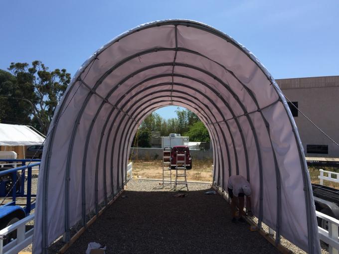

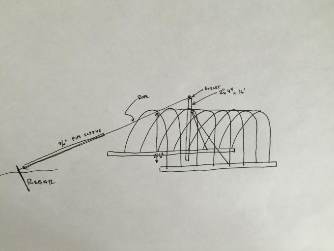

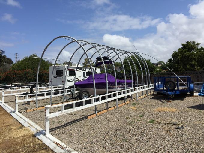

                  So.... I built a boat barn for not so much $. It is 13' wide x 30' long x 13' high at the peak. About $900 to build. $300 was a custom tarp from billboardtarps.com BTW - Billboard Tarps said this should last 7 years in the sun. It is VERY heavy. Maybe 5 or 8 times as thick as a cheap blue tarp from home depot. After about 20 months, I see no signs of wear. It is just dirty on top as I'm parked 1/4 mile from the freeway.
                  • The base is 16' 2x4s x 2 on each side connected with steel plates to make 32' long 2x4s, which are anchored to the ground and then the tarp is anchored to them.
                  • I cut 10' long x 5/8" rebar stakes in 1/2 (60" each) and welded a large square washer to each about 16" from the end. These anchor each hoop and are 60" - 16" = 42" driven in to the ground and bolted to the 2x4 incrementally through the large washer.

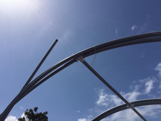

                  • The hoops are made of bundles of 3 x 1" UV grade (conduit) PVC zip tied together. One of the 3 of each hoop has a Tee installed for the top backbone.
                  • The tarp is anchored to the 2x4s by threaded eyelets in the 2x4 and some bungee cord. The tarp has a sleeve across both bottom edges and lengths of PVC pipe are slid through. A hole is punched above the sleeve for the bungee anchors to pass through.
                  Later, I added a solar panel and charge controller, another $100, to top off my batteries between days on the water.
                  I also added a 12V computer cooling fan running on a timed relay, which is programmed to run for 4 days to keep air circulating under the boat cover between trips. This allows the carpet to dry out and also keeps mildew from forming.
                  The solar panel offsets the consumption of the fan and brings the batteries back to 13.2 float voltage for my mostly weekly trips.

                    Wow--thanks for all the info! I think that might be beyond my skill level and being in florida, I'd be afraid of not knowing how to anchor it effectively against 100+ mph winds. But that looks great and I'm sure lots of folks will benefit from your design and detailed post.
