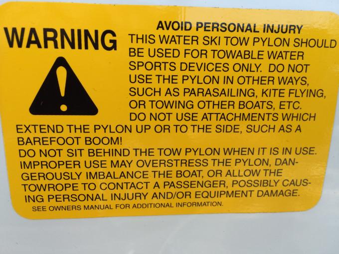

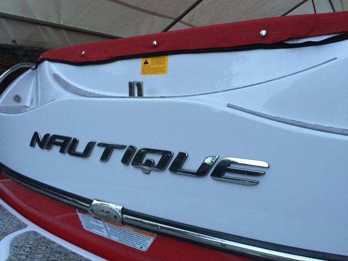

    Any suggestions for methods of attaching a rope to the transom towing / lifting eye? It seems a somewhat daft design as you can't loop a rope around it in the normal fashion. The information sign suggests this can be used for towing, however generally referred to as a lifting eye.

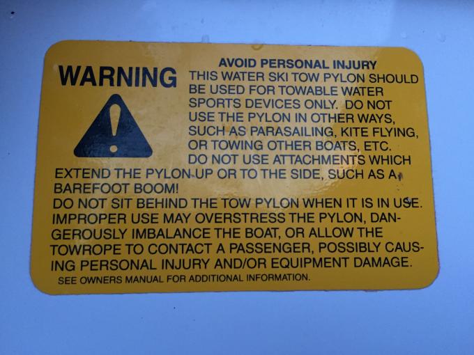

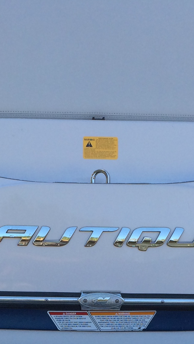

    From the pic it looks like your ski pylon could be possibly broken? It's supposed to pull up twist and lock, with a place on top to connect rope. I've included a pic of my 09 210 and you can see the top of my ski pylon because it's not all the way down. But notice the eye on top for the rope, I believe yours should be the same.

      Certainly no damage to mine, just looks to be a different design. I'm reluctant to use a small length of rope and shackle as it will likely bounce around and damage the gel.

        Does yours pull up anymore that what's shown in your pic? Yes it does look different, but it is there for towing and not lifting the boat. To answer your question as to how to connect a rope to it, you just pull the rope thru the eye until desired length then put the handle of the rope thru the same desired length loop after it passes thru the pylon and pull the rest of the rope thru. And to remove just reverse the process. Hope that helps and I'm understanding your question correctly.

          Looking at those pics I bet that is a lifting ring and not a tow point, never seen a true tow point that was not either a ring/finger or circular like the top of a pylon or the tower tow point, technically if it is a lift ring it is designed for a vertical load, using it as a tow point could potentially cause gel cracks or failure. Safety stickers are on the transom regardless, don't think it was placed there to infer that lift ring is a tow point. If there are no lift points under your platform then I would say that is almost certainly your lift ring.
          That being said would I tow light loads from a lift ring, yes, particularly with the gel shape at that transom.

            Here's a few shots of the lifting rings under the platform and what I thought was a towable water sports pylon. Please correct me if I'm wrong, but are you not supposed to use the pylon for towable water sports?

                Nothing is broken...That is the lifting ring, not the combo lift ring, rope thingy, but of course you can use it for pulling whatever for water sports...i.e. tubes and skiers...I have read it from Nautique somewhere....Since we usually wakeboard off the tower and it was pretty infrequent when we used that I either just put the end of the rope thru and tied like 6 knots so it never got too hard to come out...Or I just used a huge carabiner clip.

                        That's definitely a lifting ring not a tow point on you boat Ally .
                        there were 3 options in 2008 IIRC. ALLY has the base option 1) standard lift ring
                        scooter posted option 2) the combo lift ring /towpoint, my boat has option 3 which is a pop up pylon (sorry no pics). As mentioned a lift ring is designed to support the weight of the vertically, it's not designed to take the horizontal forces put on it by a skier or whipping a tube around. There are a reason ski pylons and tow points have different reinforcement aspects to them than lifting rings . Simply put the tow point areas are much beefier and designed to disburse horizontal stress.
                        With that said. I'd be curious to see how the pop up lift ring is mounted compared to my pop up pylon. I have never seen the standard lift ring option in all my years in these boats. Always the combo or the ski pylon . I won't say for certain you can't tow there , because I don't know exactly how that mounts......... but considering there were two other options available that were designed specifically to pull (skiers, tubes, etc ) I would venture to say using that lift ring as a towpoint is a bad idea and it was not mounted the proper way to be used as such given the other two options were available.......but again that's merely speculation on my part
