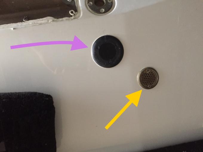

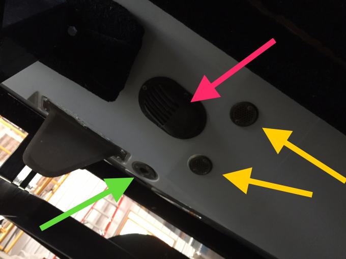

Name:	Nautique Bottom 01.jpg
ID:	523064Click image for larger version
Name:	Nautique Bottom 02.jpg
                  One pic from each side:
                  Looks like purple is transducer for depth finder; green is main t drain; yellow is three ballast drains; red is the screen/pickup for ballast inlet. Correct?
                  I'm assuming best bunk lift set up would be wide enough to miss all of it; Ballast drains might not be a big deal--but best to avoid as much as possible.
                  Any thoughts/suggestions/comments?
                  Thanks.
                    Thanks.
                    Just like every said measure trailer bunks. Your trailer bunks miss all of the underwater gear you pointed out.
