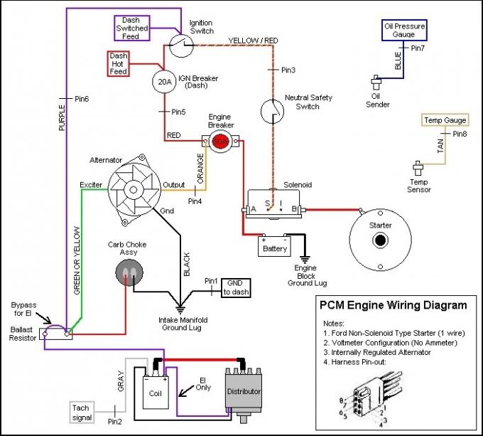

                  Well if that's the case than I'll look there. Wish I had an electrical diagram for where the kill switch wiring goes cause that was bypassed decades ago

                    you can certainly have an electrical problem that would let it crank but not start. Just depends where the electrical problem is. Get out your volt meter and start tracing.
