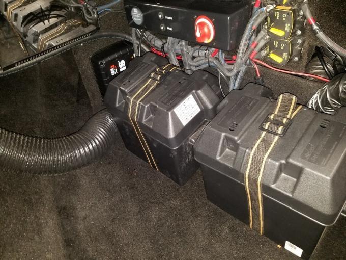

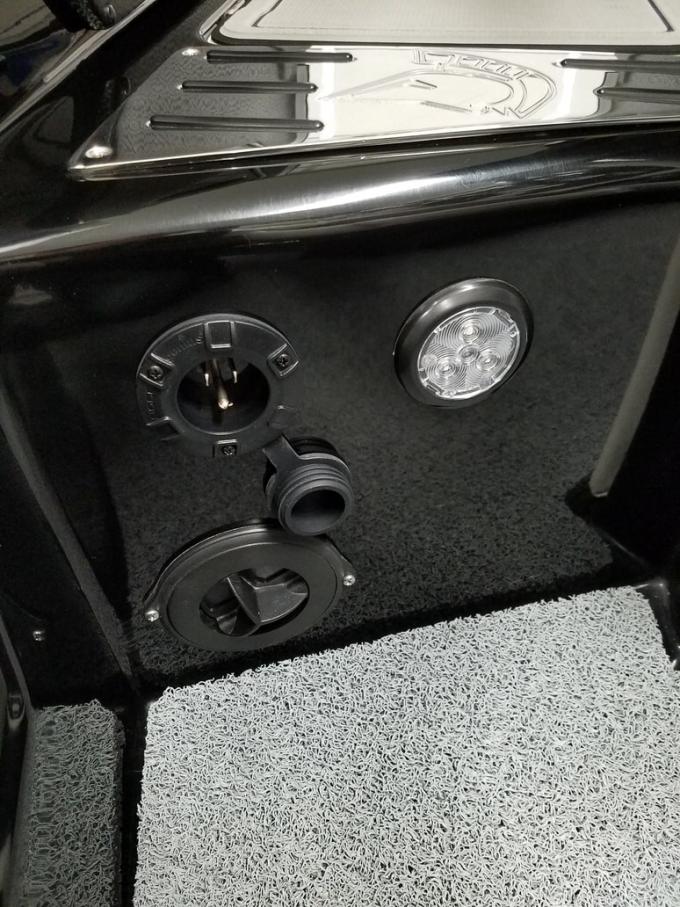

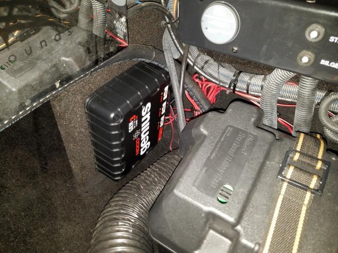

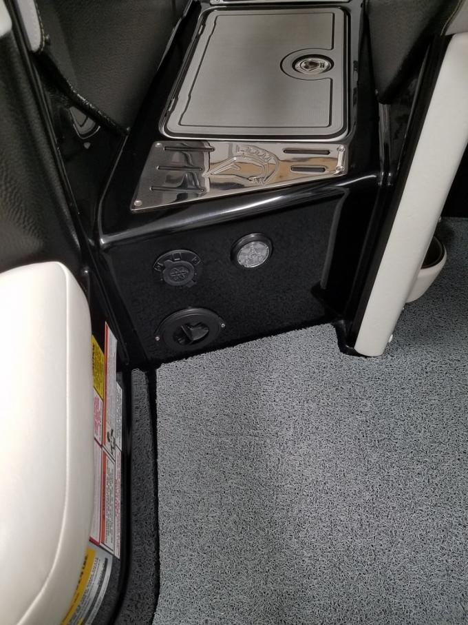

                      GMLIII Sorry for the delay posting these pics, I just went to pick the boat up last night and got her home. I would like to take credit for how nice and clean this NOCO install is, but MLA did the install for me. Could not be happier with how it turned out looking! I bought the 12 amp, 3-bank NOCO for my 3 batteries under observers seat...and the accessory piece (extension cord plug in) is located on the front of the built-in cooler so the system can be plugged in without opening the seat. I have seen it located there from factory and since it seemed like a great place that would also blend in due to my black gel-coat, seemed like a great place. I got 2 pics of each, 1 close up and 1 from further back...if any more specific pics needed, let me know.

                        Looks great. So is the NOCO charger hooked up to your 3 batteries at all times?
                        • MLA
                          • Dec 2009
                          • 1312
                          • Lake Wylie NC Area
                          #27
                          Yes, thats how on-board chargers work. They are a permanent install and then plugged in to AC when boat is not in use.
